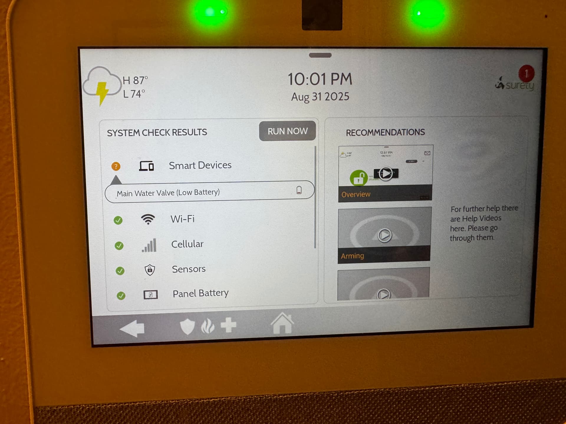

Hi…I just installed ZAC36LR automated valve. Everything is reading correctly. Except it keep giving low battery warning. Running latest firmware for both panel and valve. Does anyone know why there a battery warning.

Yes…the error is showing on the health check and the screensaver.

This is what is showing on my screen.
