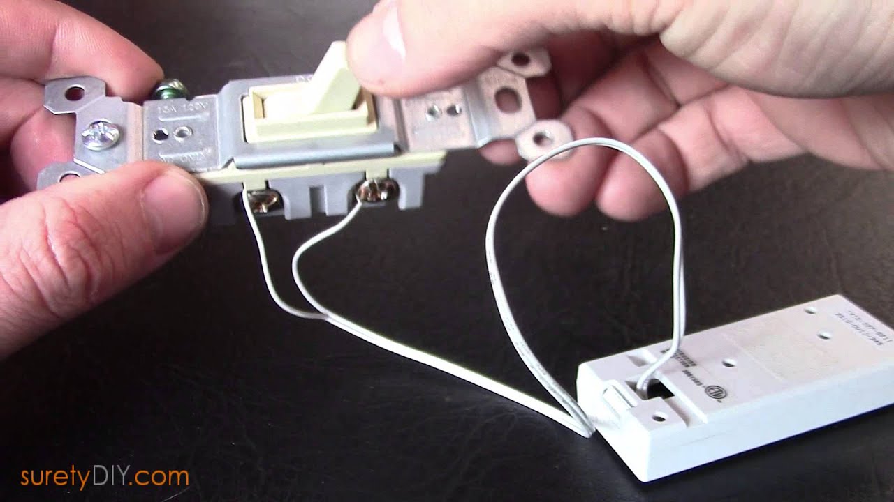

There is another option though for your remote light switch. You can create your own switch to control the zwave light, and still keep your 2GIG as a primary controller…all you need is a DW10

But as stated, I believe it may be incompatible. I would say an easy solution is to use the video suggestion we created that was posted above. Simply using a 2Gig thin door sensor and a switch would allow you to place the switch anywhere the thin door sensor could maintain signal with the control panel. Plus the components are inexpensive.
