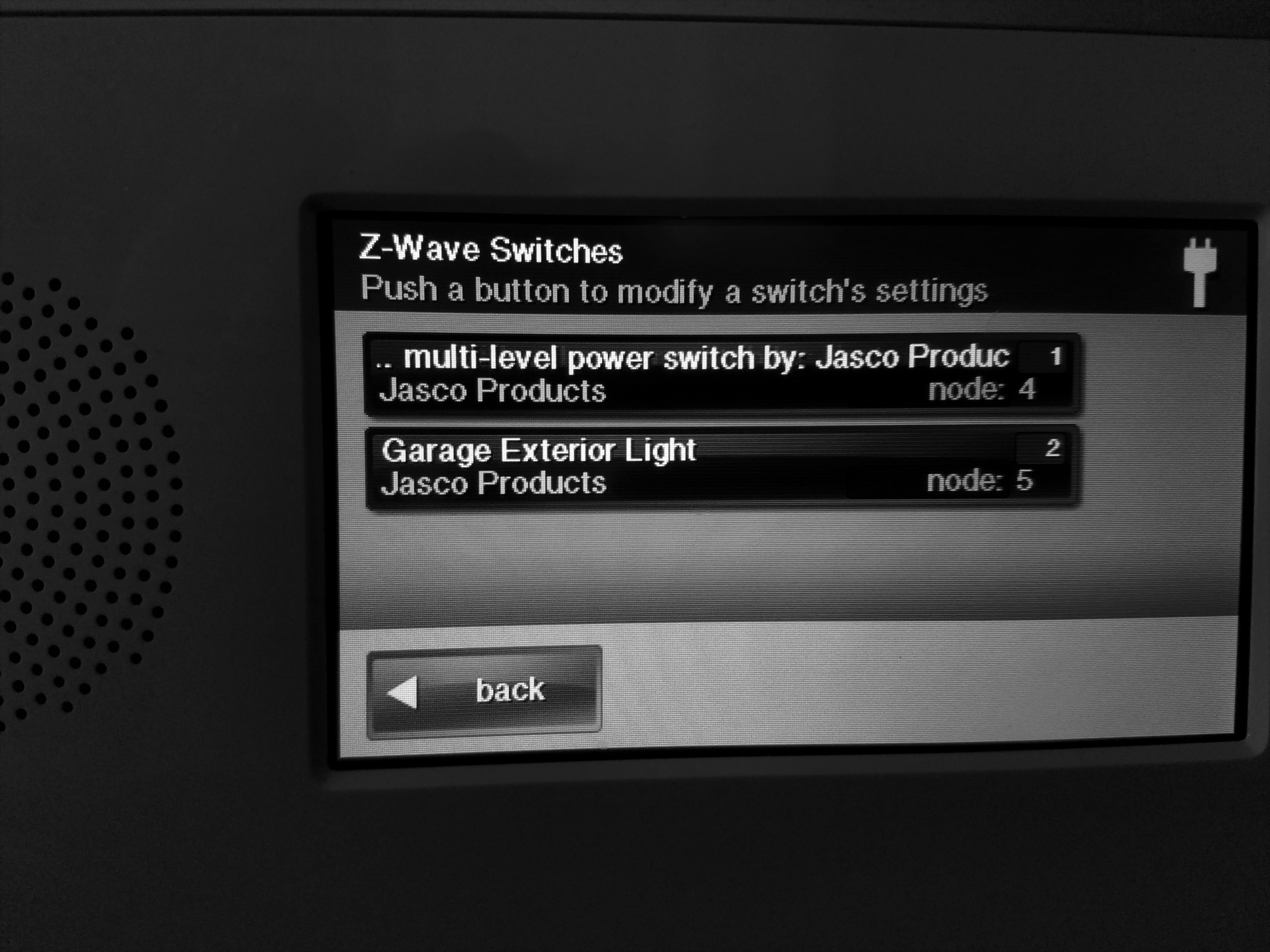

Thanks for the reply and refresh command, but there are two switches that are on my Zwave network. The one you’re noticing has always been there, its the new one that I’m not able to show up on ADC.
Node 4: Multi-level power switch by Jasco Products (This is the one not showing up)
Node 5: Garage Exterior Light (This is the one listed on ADC account)
Attached is the pic of Z-Wave switches on my 2gig panel. I have three more switches that I have to install soon.
Both nodes you are reporting are showing on the Alarm.com equipment list. Do you not currently see node 4?
