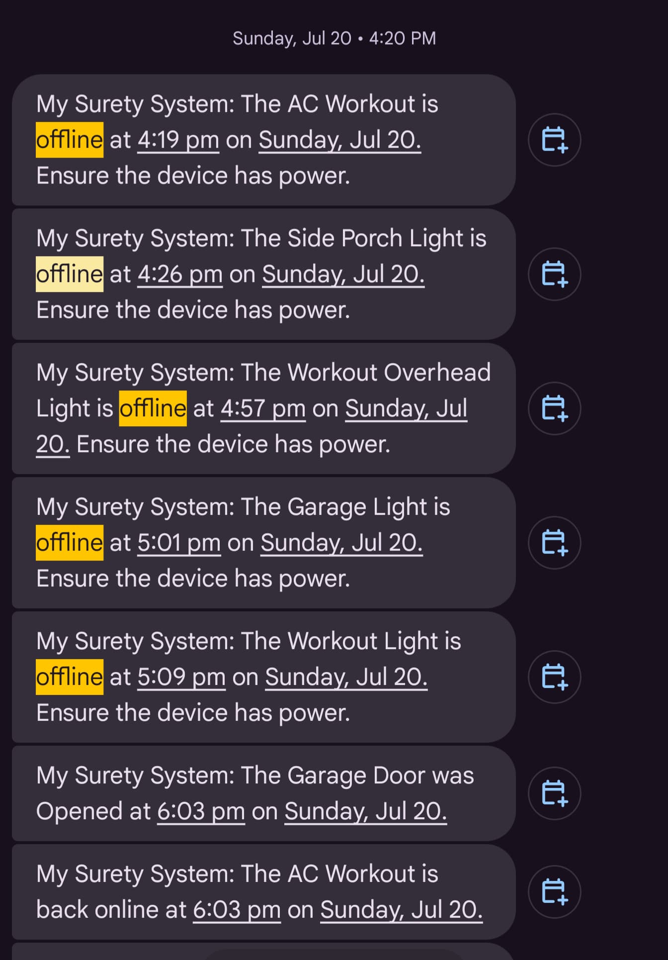

Would you say that most of these devices listed in the image are:
  1. farther away from the panel than others devices
  2. farther away from other repeating nodes than other devices that dont have this issue?
I’ve never paid attention. Those devices (in the pictures) aren’t particularly far away from the hub but they all are on the same side of the house. Next time it happens I will pay attention to what device loses connection first.
Its possible that losing one of them is causing the rest to fall off.
Z-Wave commands jump from node to node (up to 4 hops) through the mesh network. Z-wave devices that are plugged into power (not battery only) act as repeaters allowing you to carry the signal farther. If one of the closer nodes goes down, others may follow.
Next time you see this happen, check Z-Wave Diagnostics found under Z-Wave Diagnostics in System Tests. This will bring up a network map. This may help pinpoint the culprit.
