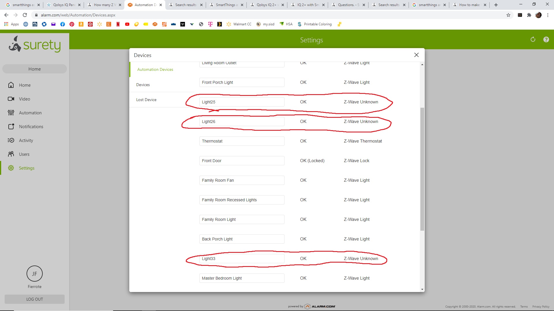

I decide to make my Qolsys IQ Panel 2+ my secondary z-wave hub and Smartthings my primary. All my z-wave devices where sync properly on my IQ Panel, but on Alarm.com my z-wave plus devices show up as z-wave unknown. All my z-wave non-plus are working, like my Yale door lock, 2gig thermostat, and GE switches, except the z-wave plus versions. Are these not compatible as secondary devices or is there some settings I’m missing to make them work. The only reason I keep my Smartthings hub is to link it to my Logitech Harmony Elite Remote.

Z-WAVE FIRMWARE VERSION 6.51.07. The switches show the same, I’ll give a few minutes to see if their is any changes, if not I may have to revert back to the IQ Panel.
