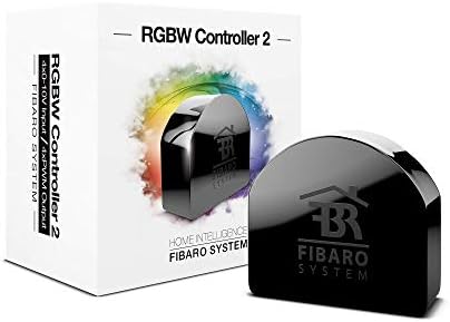

However, I’ve been unable to find any z-wave switches that are rated for AC 12v low voltage and compatible with alarm.com. The closest I’ve come is an RGB controller:
However, it is not compatible with Alarm.com or Samsung Smart things. Any help would be appreciated.
I am not aware of any officially compatible low voltage switch. If the device is not compatible with Smartthings it will likely not work.
