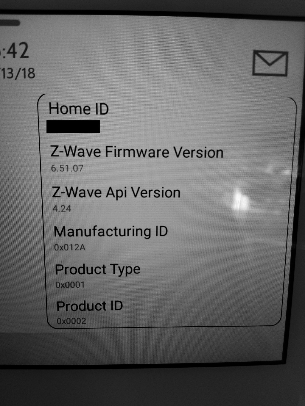

If you wait a bit after a reboot, are you able to later get status and send any commands? If not, could you provide a photo of the About page Z-wave details for your panel?
After a reboot and waiting a while (even over 24 hours) it still won’t let me change the state from the gui, but I can still get the current “status” (correctly updates if I manually activate / deactivate the switch.
I’ve attached the z-wave details, but home id seemed like it might be sensitive information, so blacked it out for this forum post.
I will check with Qolsys on this. The Z-wave firmware is slightly different between the panels we used and the info you sent, so that may be related, but we would need to verify. Will follow up when we hear from Qolsys.
