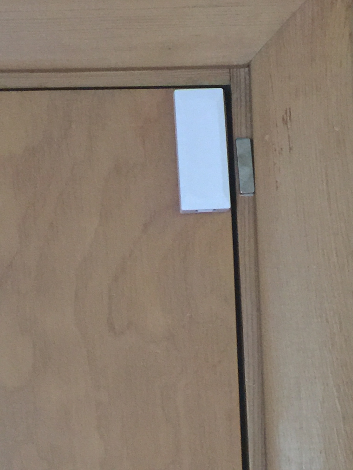

I see the door as reporting open currently. Is that the case or is it still not reporting correctly? Can you check and make sure that when adding the IS the first time you didn’t accidentally alter the loop of the door sensor?
Commonly when a sensor does not report close after opening it indicates a loop issue.
If you are on site, can you double check to make sure the door sensor was not physically affected in any way. (magnet isn’t loose/gap is less than half inch, etc.)

... the door is reporting open again. It’s currently on loop 2...
Verify the programming for the door and IS.
I can tell you right now though, that if it is a DW20R (recessed) and you have it programmed as loop2, then it is programmed improperly. It should be loop1
The window contacts are loop2
The PIR Image Sensor is loop1
A surface contact (e.g., DW10), using the wire leads for a wired switch or sensor (e.g., overhead garage door reed switch) will also be loop1

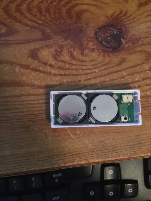

Figured I’d take a look inside. I don’t think I have the same unit as you riven. Here’s a shot of mine from the inside. Also, when I took the cover off it reported a low battery. That must be what the problem is.
