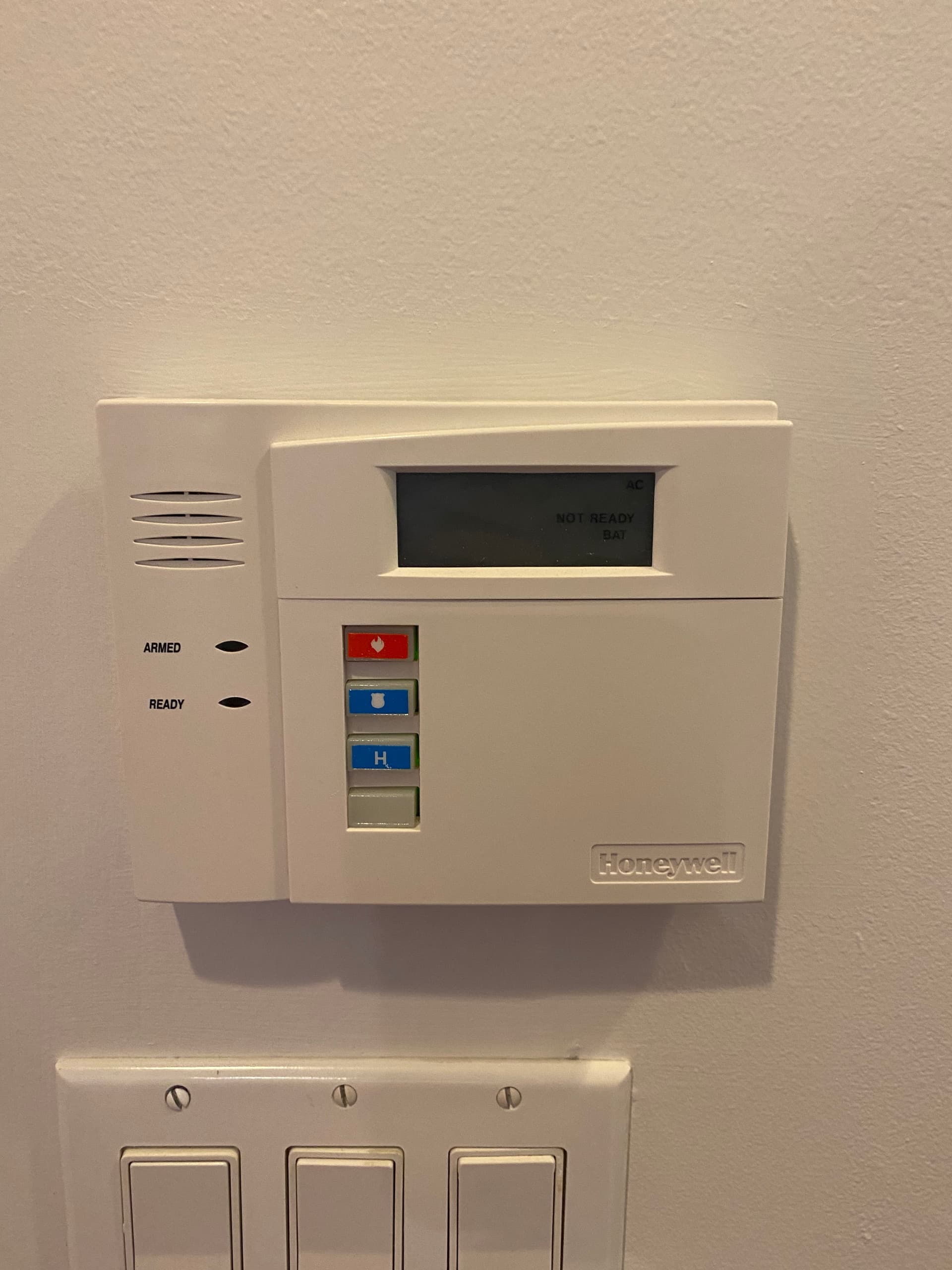

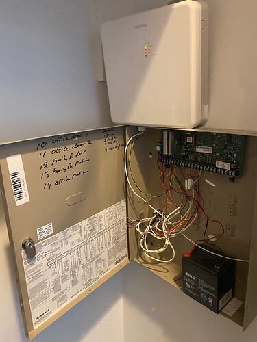

Hello,
I am looking to transition. At our old place I had wireless sensors and an IQ4 Panel and it worked great. However we just bought a place and it looks to have hardwired sensors. How would I go about transitioning over and possible going with a newer panel that would be compatible? There are cameras but I don’t think they are connected to this system :man_shrugging: We would probably also like to add an additional mini panels or whatever they are called. The quick turn on or off ones. I can provide any additional information if needed. Any help would be appreciated. Thanks in advanced.

Thank for the reply. For wiring the existing zones onto the new module is it pretty straight forward ?
Yes, zones are transferred over one for one. The IQ Hardwire replaces the entire old panel.
Here is the manual with installation instructions.
Thanks. Just got it all installed except now having a hard time getting it enrolled on the iq4 panel. I hold the enroll button on the hardwire for a bit, it flashes green but then nothing on the iq4 panel. After a while the hardwire goes to flashing red 2 times.
I actually got it enrolled, had to do it manually
