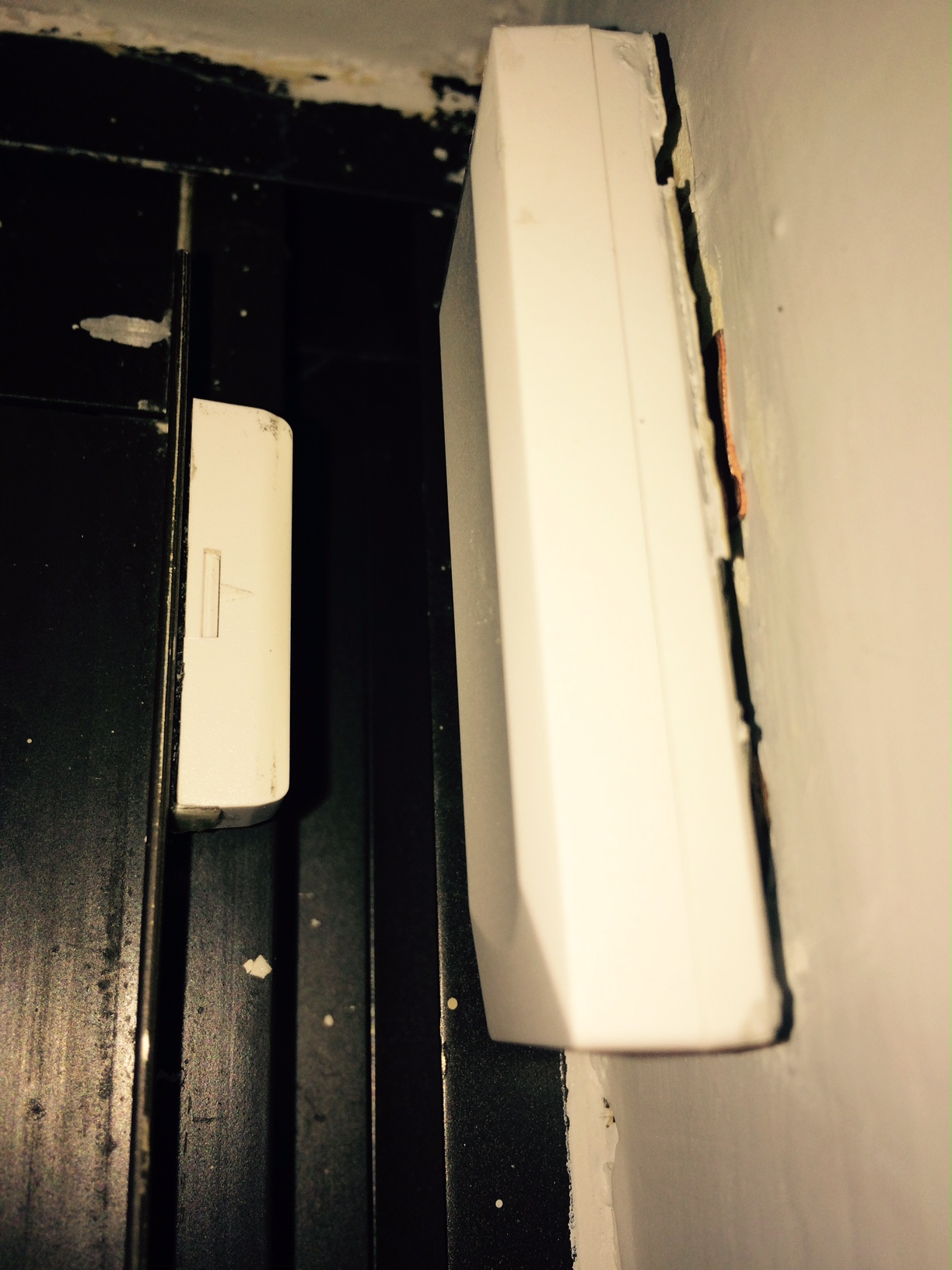

I am having issues with one window. Its the only sensor that falses. About 1 time a month or so. This is the 2GIG thin wireless contact. I have already replaced the sensor with a new one and it still falses. I did not replace the magnet though and don’t an extra one. I am thinking a stronger magnet might help?
It seems to happen on windier days, but I am not sure. I took pictures so you can see how everything lines up nicely. I have other sensors that are not line up nearly as well and they never false.
I put washers under the receiver unit to make space so it lines up better with the magnet. I am at a loss and I obviously can not have this window falsing.
This last time, the alarm was not on and it annouced window open and on the panel it showed the contact open even though when I looked at the window it was totally closed and everything was lined up.
That picture is of the window open to show where the placement of magnet is. The other picture shows it closed and the magnet is so snug you can’t even see it
Can’t show magnet in closed state. The picture without magnet is it closed and it’s in there tight
Window is metal and so are washers. The washers are copper. It was falling before the washers too. The other windows that never false and have the magnet not so close in closed state are the same metal

It is at the very top of the window, not the bottom. There is one wall and the window between it and it is 50 feet from the base. The magnet lines up right night to the sensor. In the pictures from Rive, he shows the sensor to the top of the sensor (it does not rest flush like mine does).

This is mounted the exact same way as they other windows in the same place

Sensors are fine and this one in particular has all 5 bars and the check mark.
