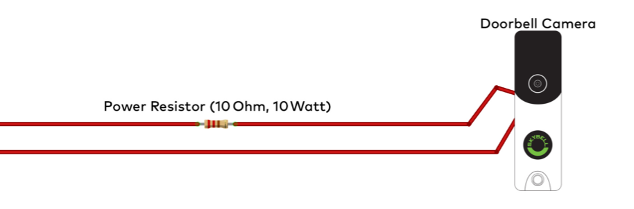

If you do not have an indoor chime and just wanted to use the Skybell by itself, you can, you would just need to follow the manufacturer instructions regarding power application.
You could just use a 12VDC 1A power supply. Note that an in-line resistor (10 Ohm, 10 Watt) is required when installing the doorbell camera without a wired, in-home doorbell chime. (see attached) Failure to install a resistor when a chime is not present may result in damage to the doorbell camera.
