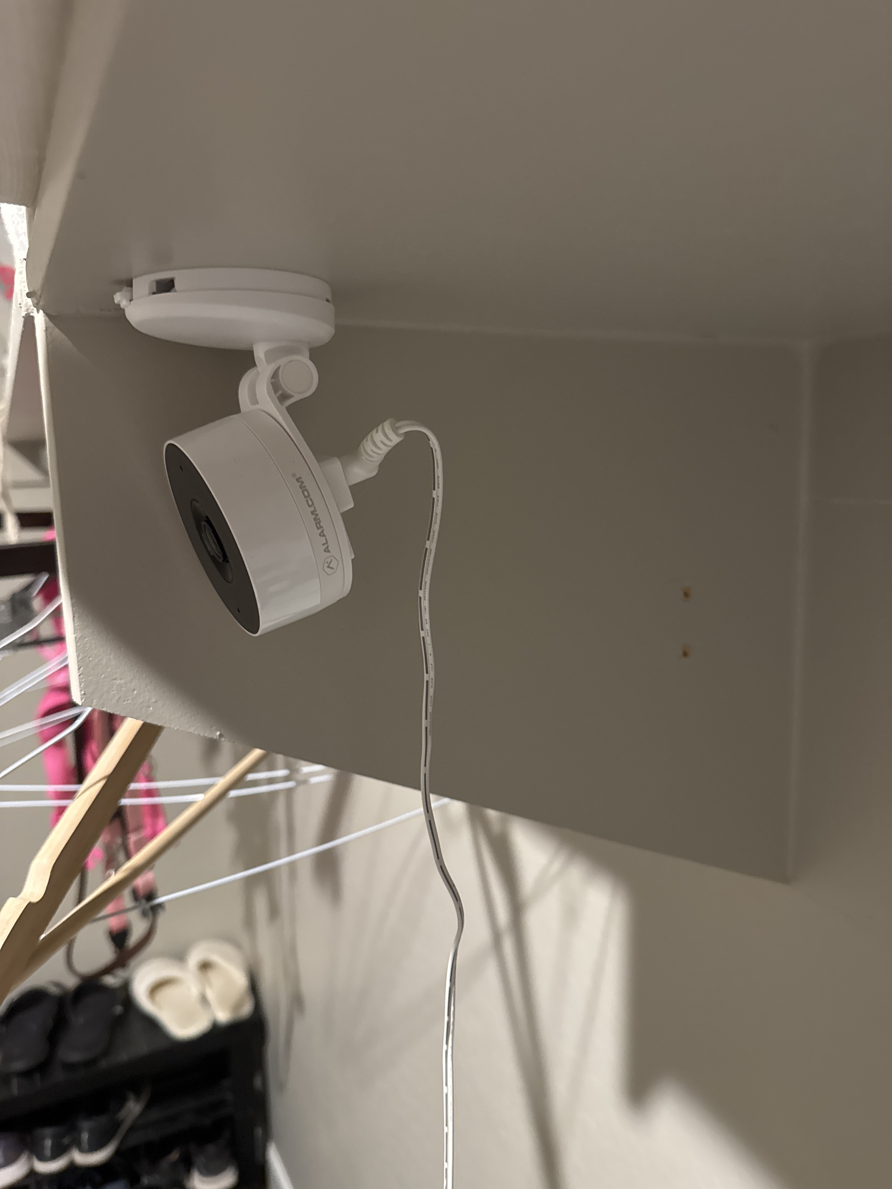

With the cameras I have most are able to be concealed at the mounting base directly into a wall, however the one indoor camera I use to monitor my dogs does have a visible wire. Outdoor rated cameras have the wire come out the center of the mounting plate, so if you drill a hole in the sheetrock or the exterior surface of your house wire would not be visible.

May I ask which indoor camera is it that you are using with the exposed wire, and would it have been possible to conceal it?
My indoor camera is the ADC-V521IR, Its no longer available new. Yes, and no as to if it could be concealed. It’s designed to mount to an interior surface, like a bookshelf, so wire plugs in on back of camera and is exposed. You could hide the power cord but it would still have to stick out of wall to connect to camera.

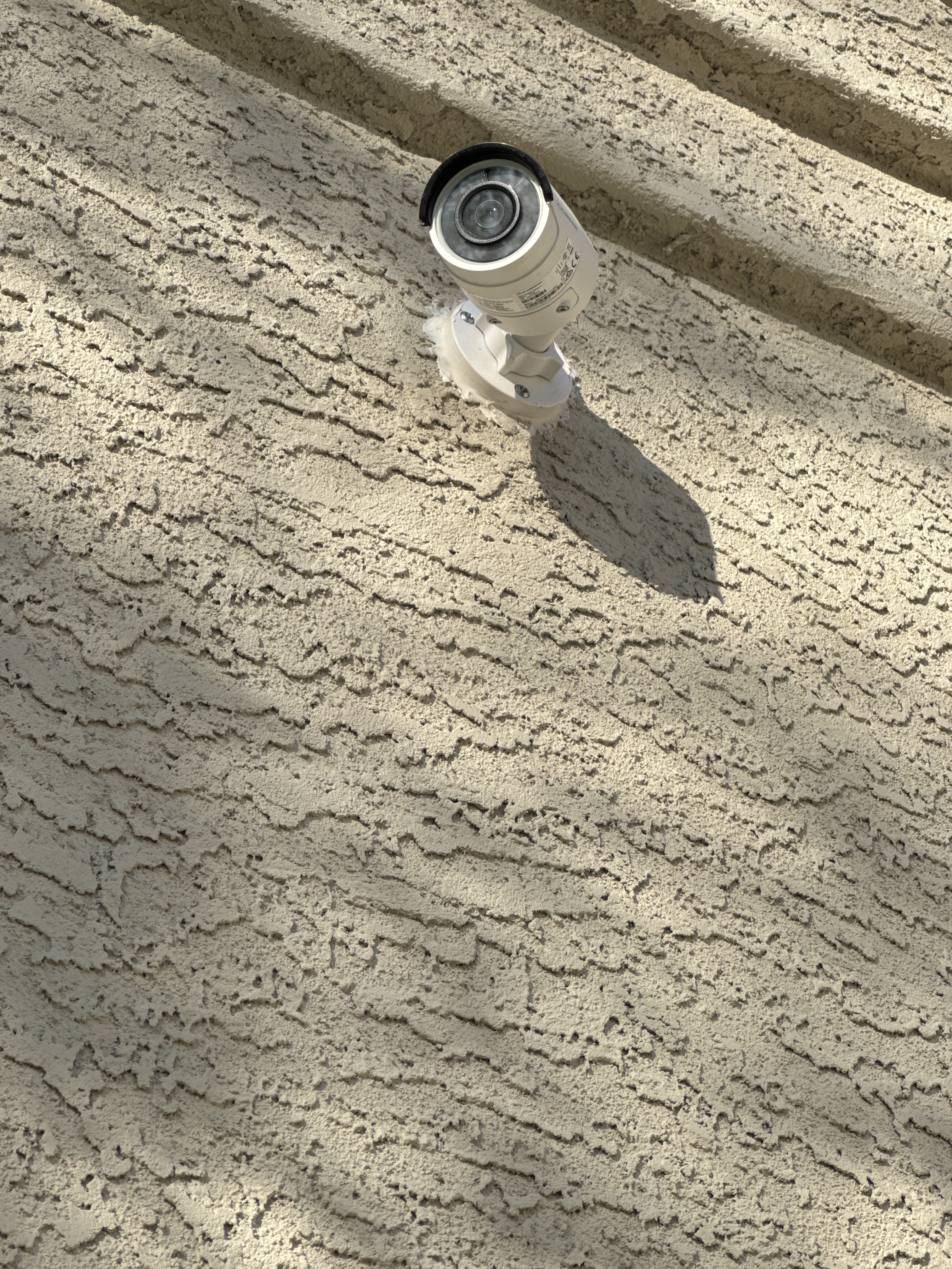

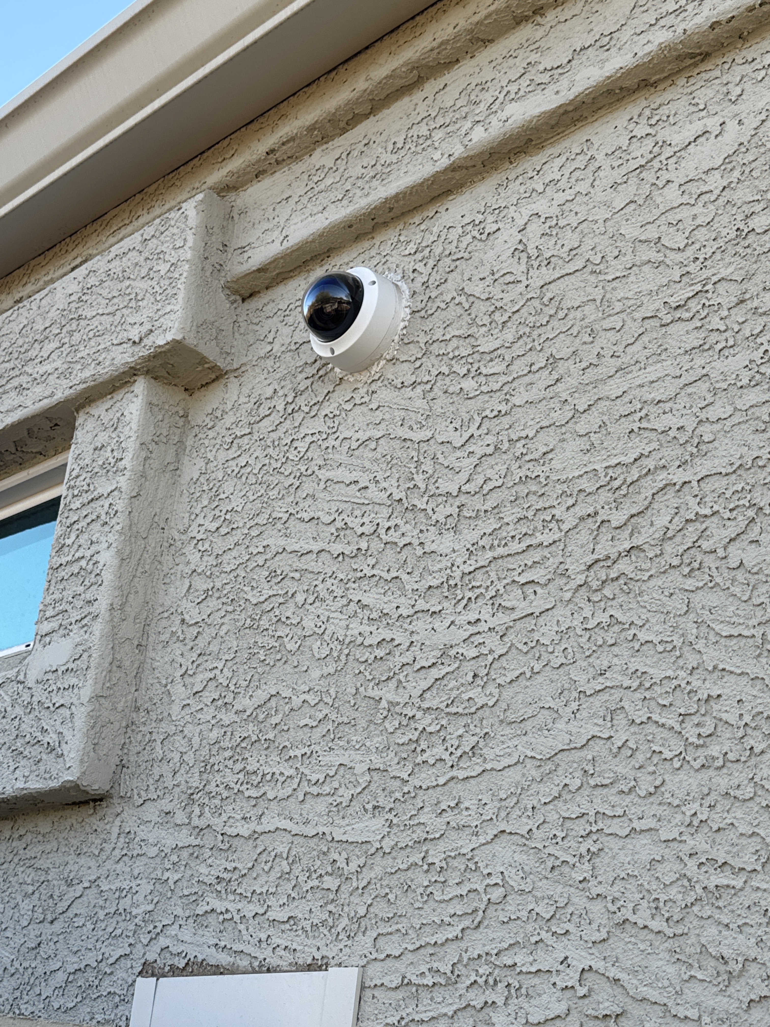

Outdoor cameras are designed so that the wire is hidden (so the power cable is not exposed, to prevent someone cutting the feed). Wires extends out the base of the mounting bracket.
Exterior looks clean. Nice work.
Thanks
