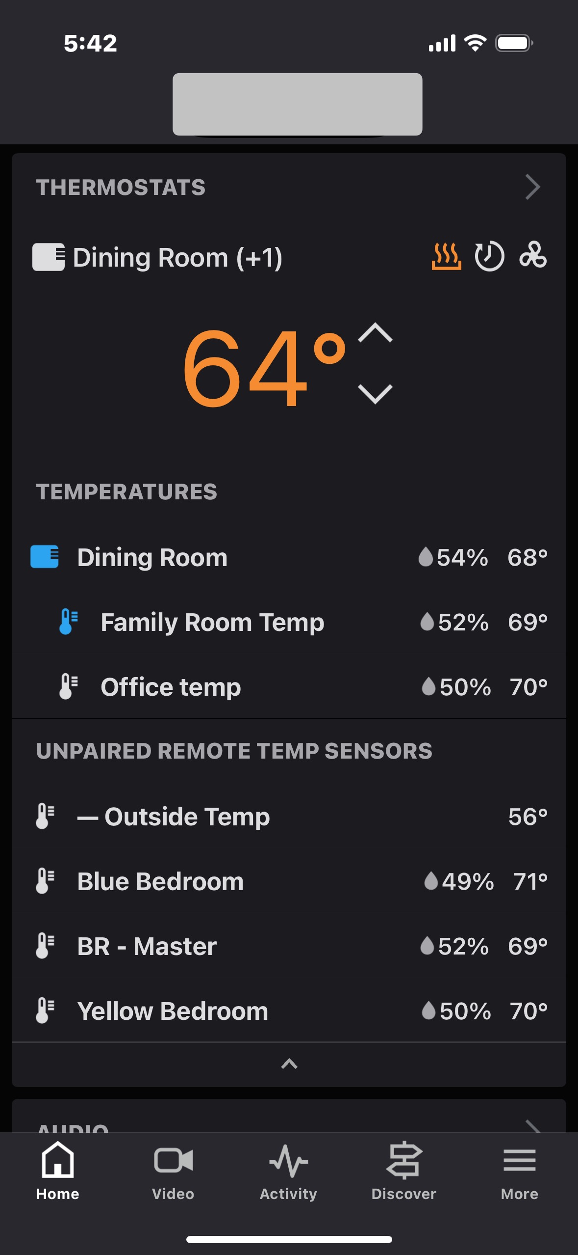

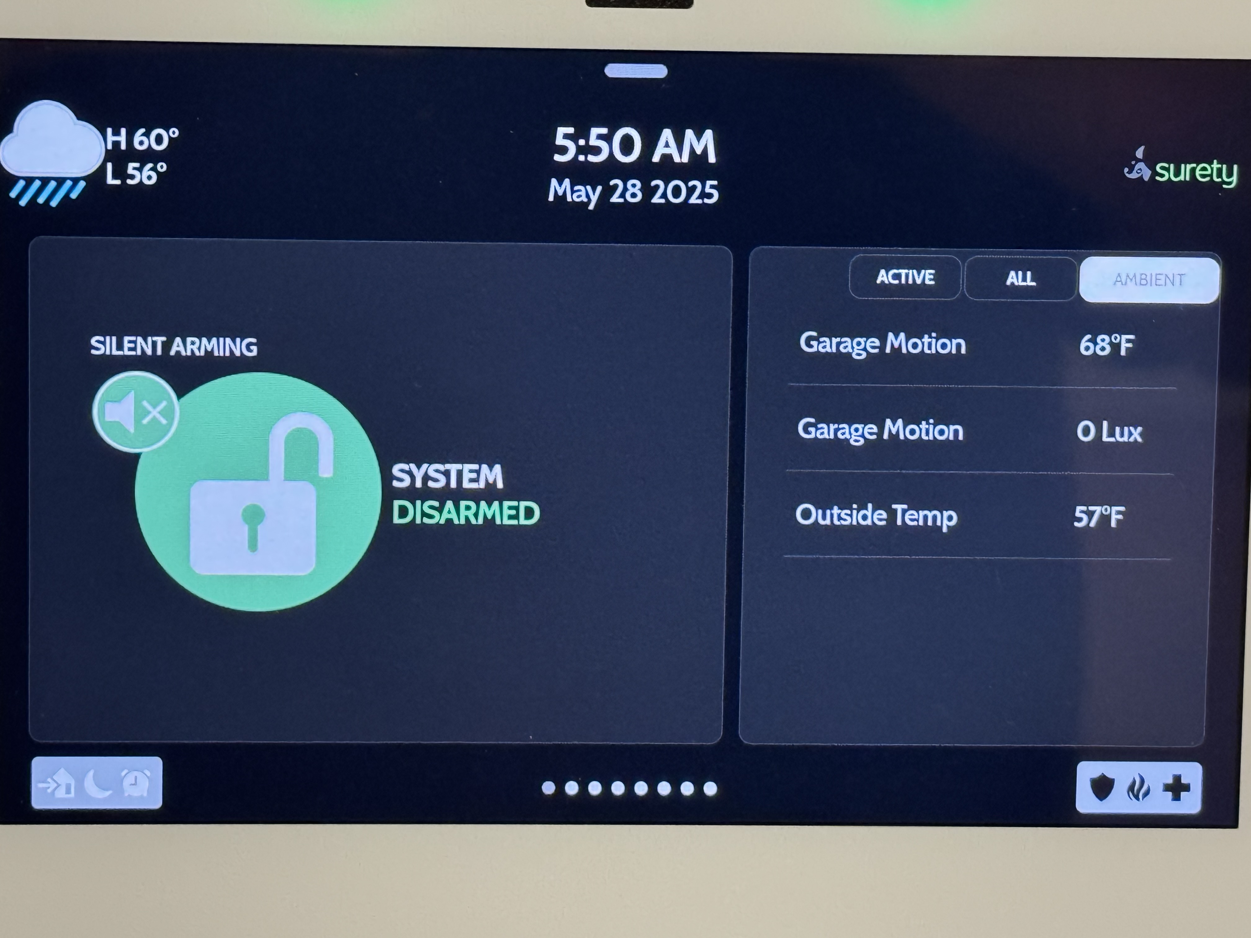

I have a PG9905 here monitoring the Outdoor Temperature. It shows up on my IQ 4 panel on the status screen under ‘ambient’ tab, and in alarm.com under thermostats as a temp sensor. Here are screenshots from my system and app. The 9905 is the “Outside Temp” sensor.

Thanks for this. I see it in alarm.com App when I expand the thermostat section.

I do not see it on the panel. I’m using Nest thermostats, so I don’t have the ADC thermostats on the panel.
I have an Active and All tab, but no Ambient tab. Is there a setting somewhere on the IQ4 to enable that tab? Thanks!
Yes I believe that is a setting.
Advanced settings , installation, dealer settings, under the PowerG section, turn on “temperature reporting”
That did the trick. Thanks!
