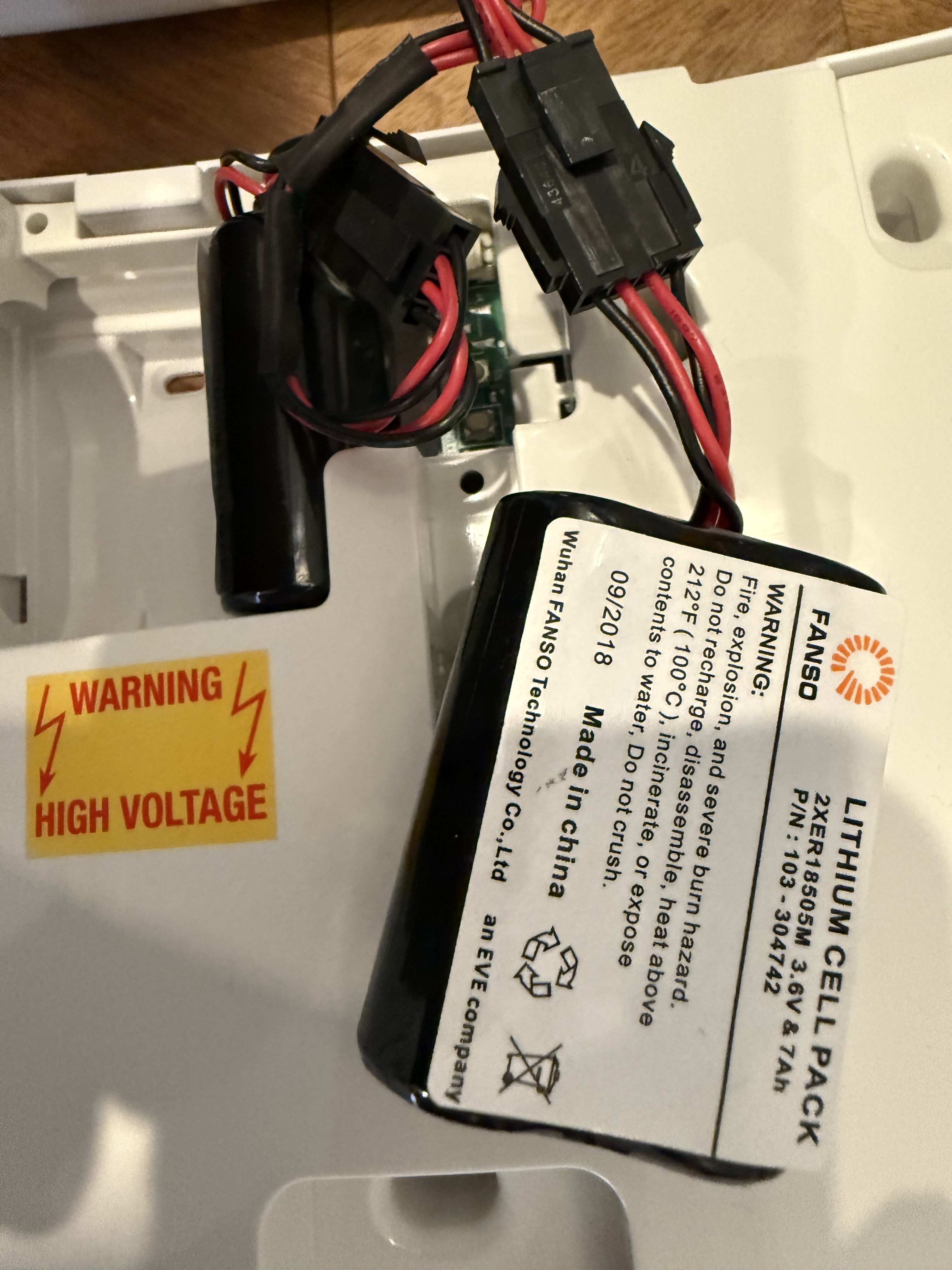

Hello, I have a PG9901 siren and the battery needs replacing (see photo) but the only ones I see see online are 16000 mAh instead of 7000. Where can I find this battery?

DSC does not have a part number for a replacement battery.
From the manual, it uses Four 3.6V/3.5A/H Lithium independent cells
(EVE ER18505M) assembled in two plastic wrappings and connected to the cable adapter.)

A quick search online yields the following result here but I could not speak for that specific product
Acknowledging the low battery alert from the main panel (Qolsys logo top right corner of home page, then Alerts/Alarms) should temporarily silence but the beep will return until the underlying issue is resolved.
