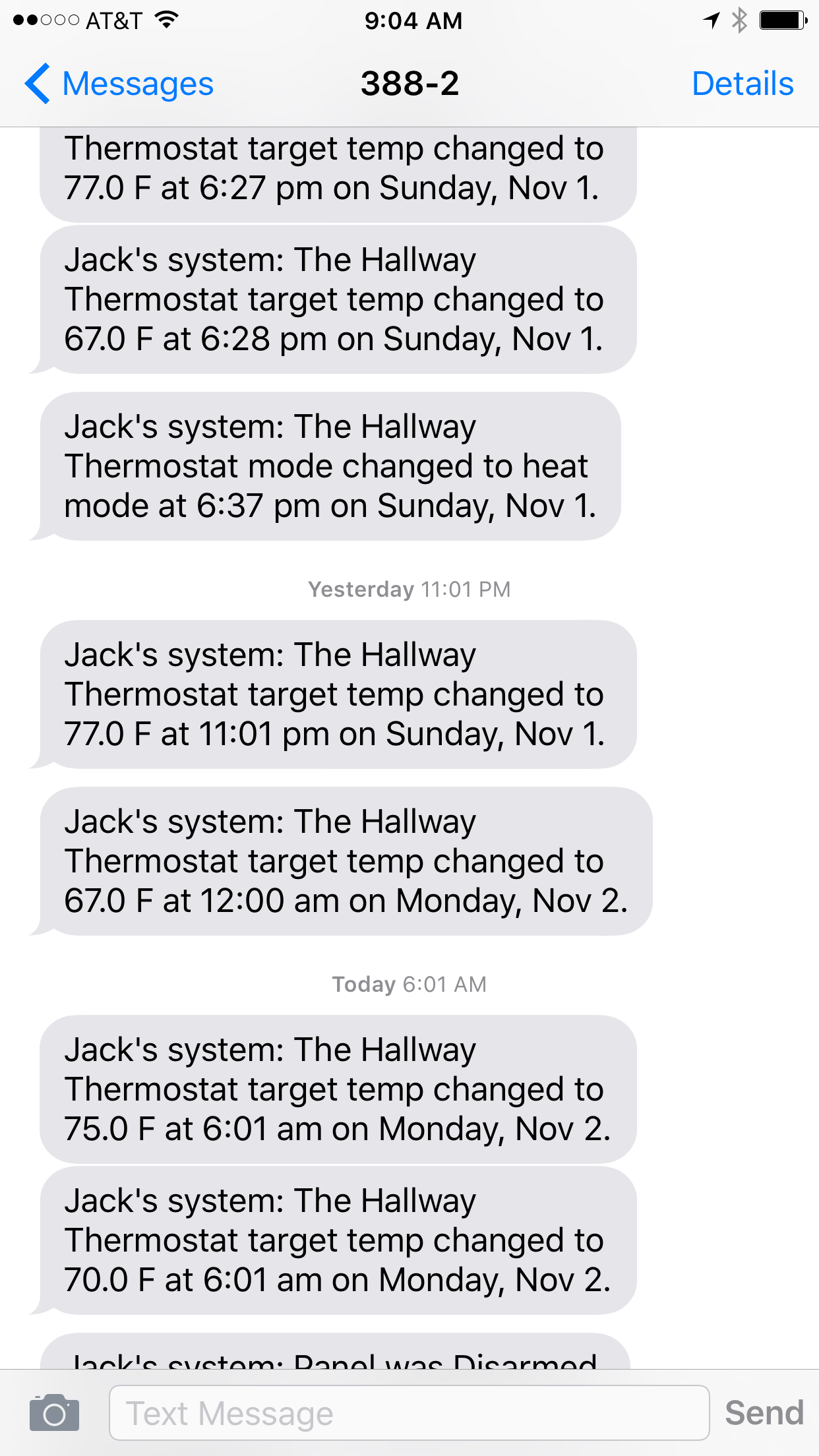

Smart away is not enabled. I’ve been getting the same text messages about the target temp changing for about 3 days now and there are different values to it too.

I was referring to the text about the t-stat changes to 75° and 70° and even the one that says it changed to 77°. Where and how are these texts even gathering their data?
I expected them when I had the t-stat on auto. After a certain time I had the temp change automatically. One temp for heat and one for cooling, right?
Now that I changed it to just heat, I should only receive one temp and then only receive it when it’s programmed to change. What also bothers me is the incorrect temps that are being sent. I did change the settings via ADC site. What is the procedure to ‘restart’ the t-stat? I know the ADC site said that it was going to restart it due to changing core settings, but don’t know if it actually did.

Actually, I did that same thing last night. I’m still getting the texts giving changing temps for both heat & A/C. Some of the temps given in the texts are not correct or even set in the t-stat though.
The texts come two at a time. The first one will usually be 77 when I have the temp change to 67 at night, which is the second text.
The other set of texts I get is when the t-stat changes temp in the morning. I do have it set to do this but I still don’t know why I get the 75 & 77 degree texts or where it’s pulling that info from.

You have the notification selected to alert whenever the mode or target temp changes, which is why these are being sent it seems. You can shut this off for the time being. If a schedule is on on the thermostat, it will report both cool and heat schedule target temps.
Schedule is off. I’m aware I’ll get notifications when the temp changes, I have that option on right now. Thermostat is in heat only mode. I have the t-stat changing temp from 0600 to 2300 it should be 70°. From 2301 till 0559, it should be 67°.
The t-stat physically shows the values put in on the ADC website.
I never had any temperature (ac or heat) set to 75° or 77° at any time, so I have no idea where those are coming from or why I’m still receiving two temps instead of just one.
From what I can tell, it looks like cool schedule notifications are for whatever reason still being generated, and there is no way in ADC currently to isolate those, say just receive alerts for changes associated with heat mode. I’ll verify with ADC today and suggest this as an option. I think the thought process is most people will use auto or ADC schedules, so both apply.
