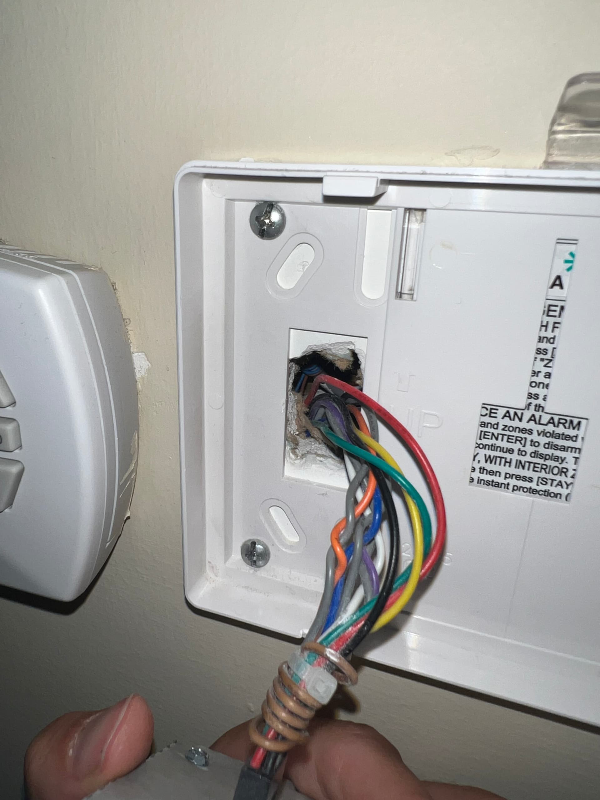

So I would unplug the wires going into the current secondary keypads and plug them into The 9309s ?

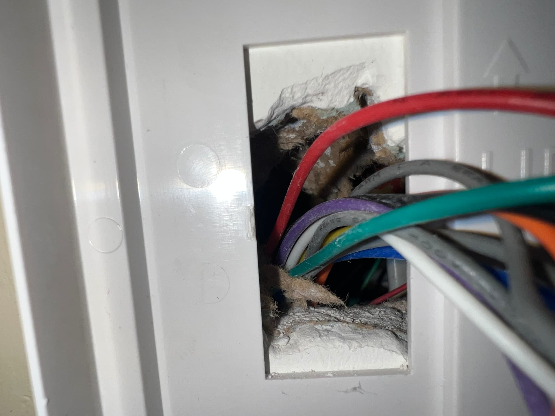

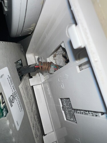

So I looked deeper into behind the two keypads and I’m just going to assume that there’s four zones on each keypad. Should I return the equipment I purchased from surety and just get a cell radio for this old system? The PG13 09 is probably wouldn’t work. I would need eight of them total to keep a 16 zone setup in this home
Pics attached

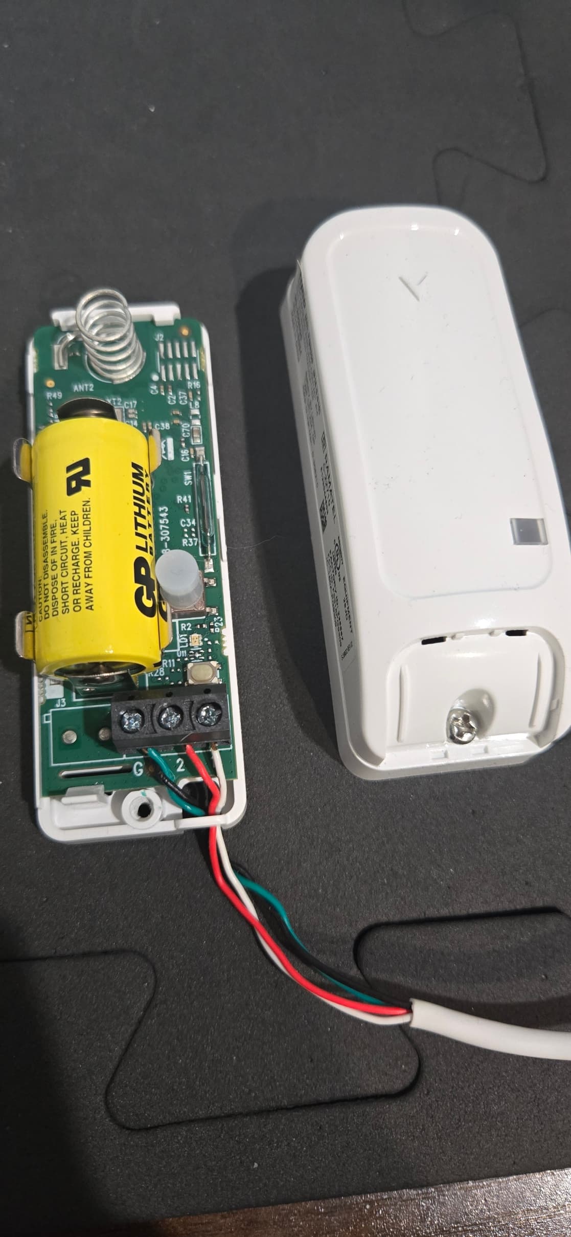

You would need 4 PG9309 as there are two available hardwired zones on each. You would also need to make the hole a bit bigger to be able to insert the sensors inside.
Alarm.com does not make a cellular communicator for your current panel.
Based on the wiring I see at the panel, you may be able to get the wires from the keypads to the panel but I feel like it may cause issues with false alarms. I feel like the best way to go would be to put PG9309’s behind the keypads.

When you say 4 pg9309s you mean two behind each keypad so they can do two zones each on each keypad totaling 8 zones?
As for the return, I haven’t even opened the UPS box yet it’s still sealed
That is correct. 2 zones on each PG9309. 4 zones behind each keypad total 8 zones.

Yes, it would be to disconnect them from the wires on the keypad. You may need to strip the wire, and then use a precision screwdriver to tie it down on the PG9309. The wiring will look like this. The ground/common being shared by both zones followed by zone 1 and zone 2

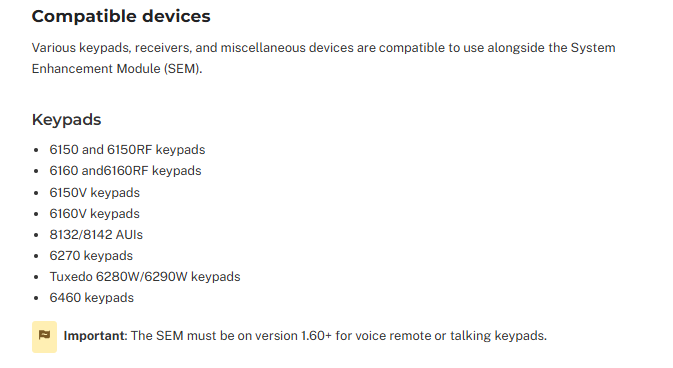

Hi Jason if I swap this Gemini to the vista p board and swap both zoned keypads to the Honeywell 6164us keypads can I install a cell communicator and have your company monitor through alarm.com?
Alarm.com has a compatible devices that work alongside the SEM (alarm.com communicator). The 6164US is not on the list of compatible devices. It may be that it will have issues reading the zones behind the keypad or that the SEM and this specific keypad have not been tested.
Ok because this seems to be the only plug and play hardwired keypad that would pick up the old zones
I think alula was tested successfully but you don’t support those devices?

Are you referring to the Alula connect+ ? We do not monitor Alula connected panels at this time.
