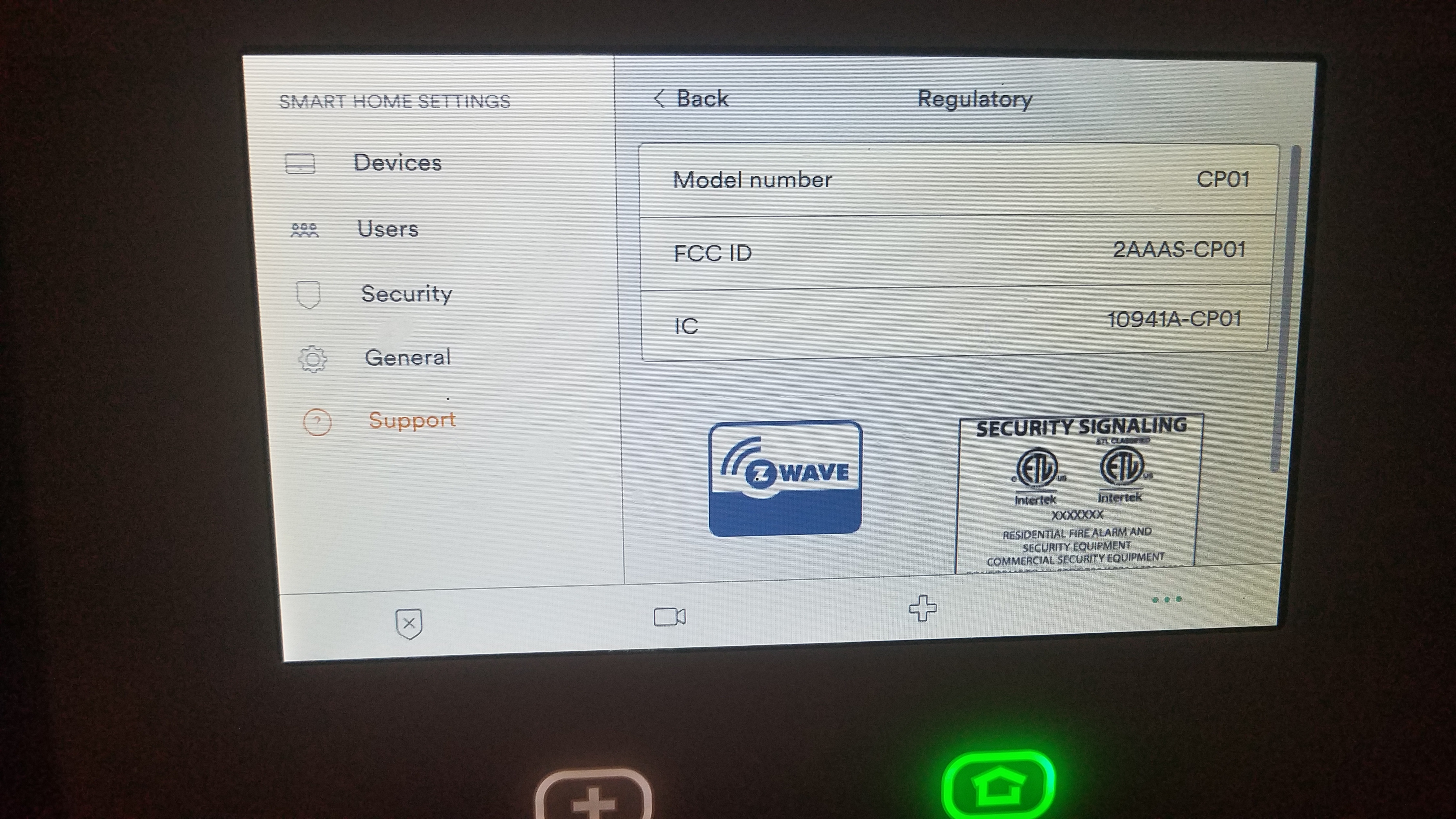

Is there any possible way to use any of my vivint devices. I have a Sky control panel, doorbell camera. Door lock, motion detector, door sensors and window sensors. I have full controll of the panel. If not what door lock and door bell is compatible that can be paired to each other. I need to remotely unlock/lock door and view visitors same time with door bell camera. Basically the same features vivint offered but without the high cost.

In short, the panel and doorbell camera would not be compatible, but the door lock, if removed from your current system, could be reused.
Any standard 345 Mhz alarm sensor could be reused as well, this will be most of the sensors. The -2 versions of sensors (like the GB2 instead of the GB1-345) typically are not compatible and should be replaced.

You would need to replace the panel with an Alarm.com compatible panel, like the 2GIG GC3.
