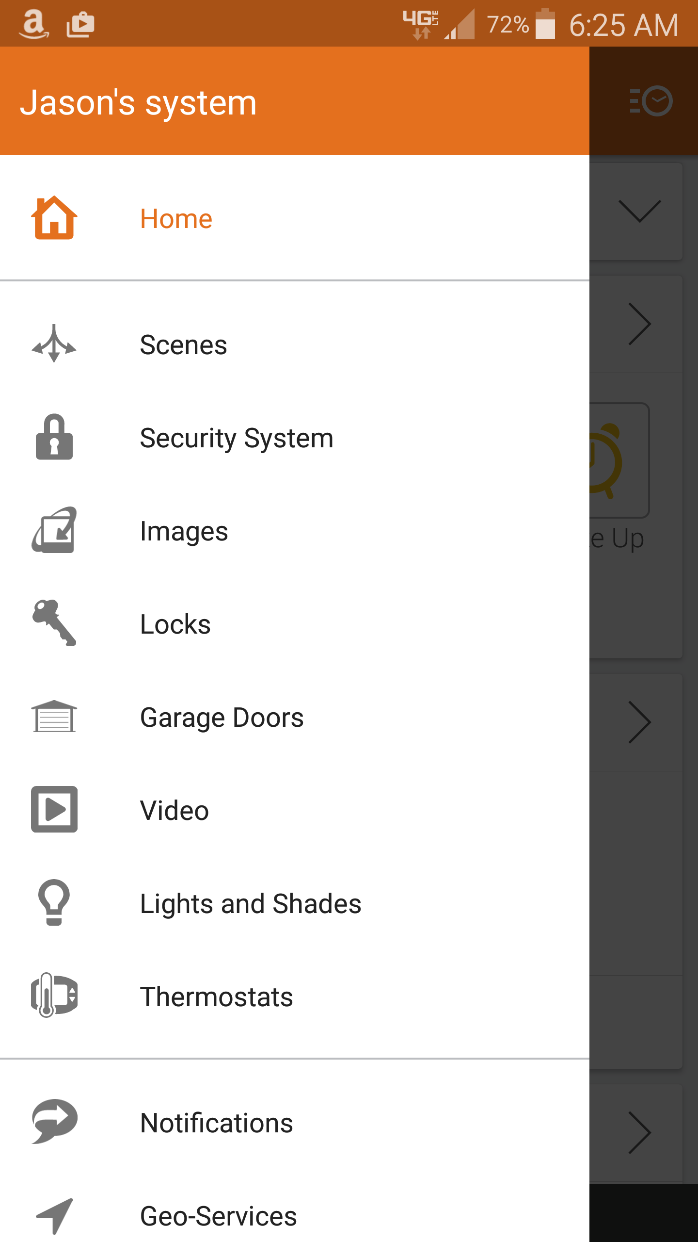

It’s blinking red and green for me but my alarm.com account doesn’t show video doorbells anywhere (just my other two ADC cameras). I assume that means SuretyDIY needs to turn that feature on for me?
Looks like I might not be doing much more with it until Monday if that is the case…
Red/green means it’s in pairing mode. Fire up the ADC app, go to Doorbell Cameras, choose add a doorbell camera and follow the instructions. If you have video enabled on your account I don’t think they need to do anything else.
Not an option for me.
I’ll ask Surety to enable it on Monday.
Yes, Doorbell Cam access is not enabled by default if you have existing Cloud Video service, you can email customerservice@suretyDIY.com to activate it. I’ve had it enabled for you. You may need to log out and log back into the app to see the change.
Thanks Jason! The option is now available for me.

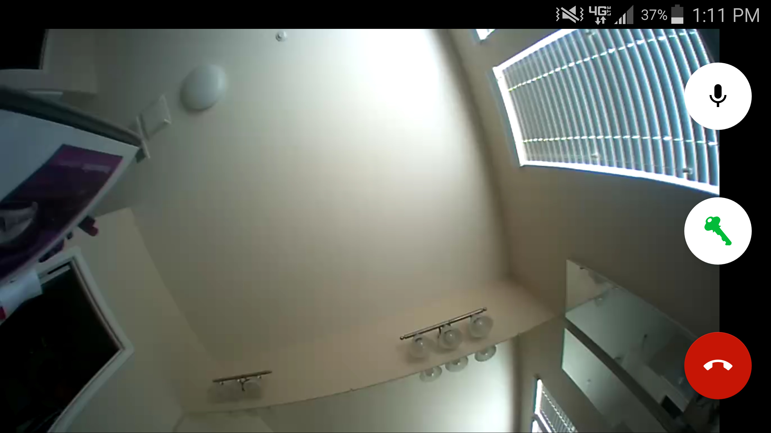

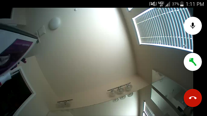

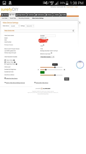

Retail Skybell HD synced without problems to my Alarm.com account.
Only hiccup was needing to turn off mobile data on the phone for it to find the wifi.
No firmware update occurred that I could discern.
All settings work properly.
Thanks for following up. Great news, let us know if you run into any issues!
