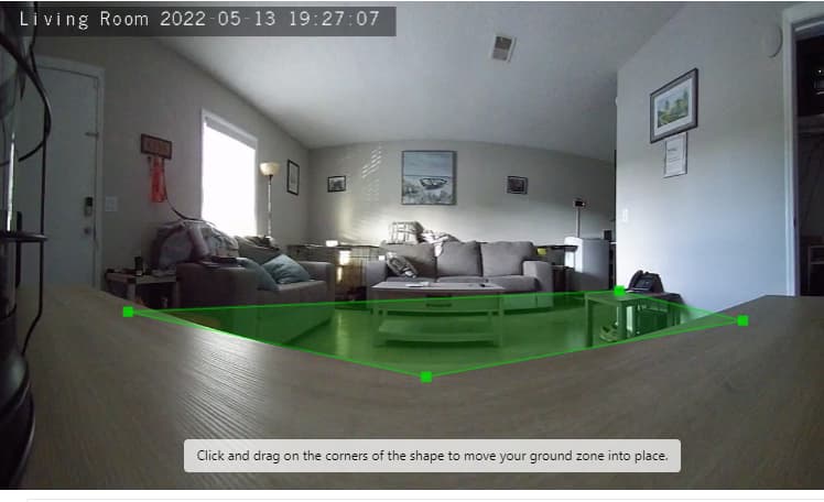

Just set up my V622-WELL and defined the ground zone as below. I have it set up for the rule to be active at all times unless my phone is in my home geofence. Currently at work and cat has walked by in the ground zone several times and no recording was taken. I have attached an image of the ground zone and of the recording rule
i did notice it says AT HOME on the motion rule itself. does this mean the system thinks that I am home or meaning the rule is Off when I am at home
Update: I got the analytics working once I figured out how to make custom ground zones. Ended up also changing the rule to at all times except when panel is disarmed. Seems alarm.com wasnt reading my location correctly on my phone for some reason. Any Idea how to fix this? Also a couple follow up questions:
