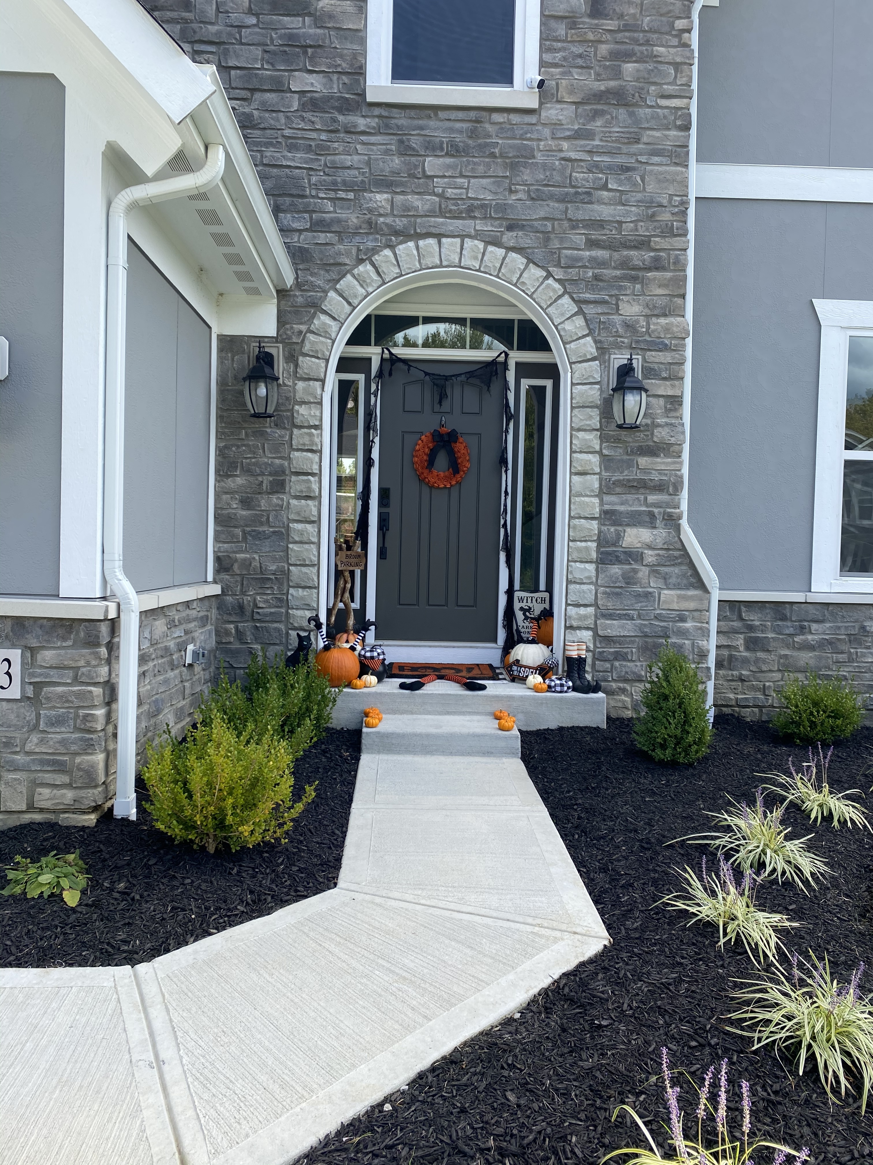

To give you an idea of my set up, I have the camera outside of a second story window that overlooks my front yard and the sidewalk that approaches the front door. Because of the extreme field of view with this camera, I can actually point the camera in such a way that it actually does not really look like it would capture where portions of the tripwire are located. The portions of the trip wire that are not being activated when I cross it are in the very lower portions of the screen when I set up the trip wire. Where the tripwire is further from the lower portion of the screen and out further in the field of view of the camera, the trip wire does get activated. I thought if the trip wire is anywhere in that field of view on the screen when I create the trip wire, that the trip wire would actually get activated but it appears that the camera is not catching that portion of the camera. Maybe that is because the camera is actually tilted furthest away from that point??? To troubleshoot even further I created a ground zone in that same lower portion of the cameras view to see if I had the same problem and indeed I could not activate the ground zone in that lower portion either. I hope this makes sense.

My next suggestion would be to move the trip wire up a bit in the window, or split the trip wire into two, one for sidewalk, one for the bushes, using 2 rules.
The tripwire was recording when you were further away from the sidewalk out towards the grass almost as if the camera did not like the tripwire the closer it was to the bottom of the screen. I moved The camera angle slightly and I did as you suggested and created multiple trip wires and it seems to be functioning as desired. Thx A lot for your patience and help!
