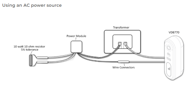

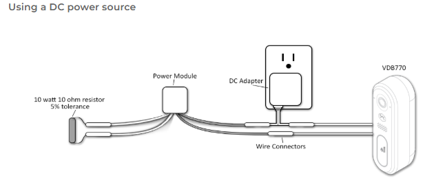

The voltage is good but what is the VA output on your transformer? Could you share a picture of the transformer? Is this 18.5V?
Are you using the Doorbell power module? Do you have a 10 Watts 10 Ohms with 5% tolerance resistor?
