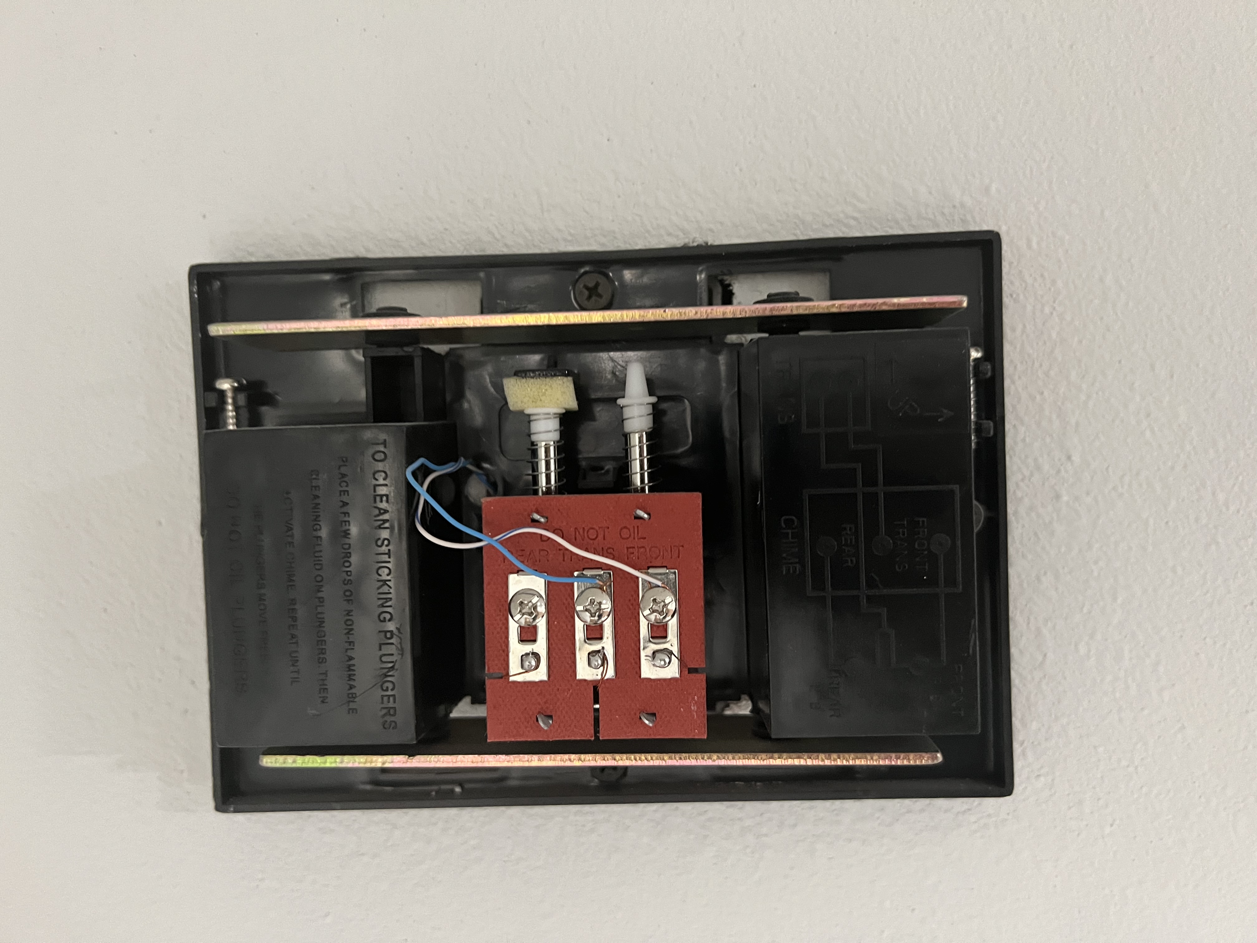

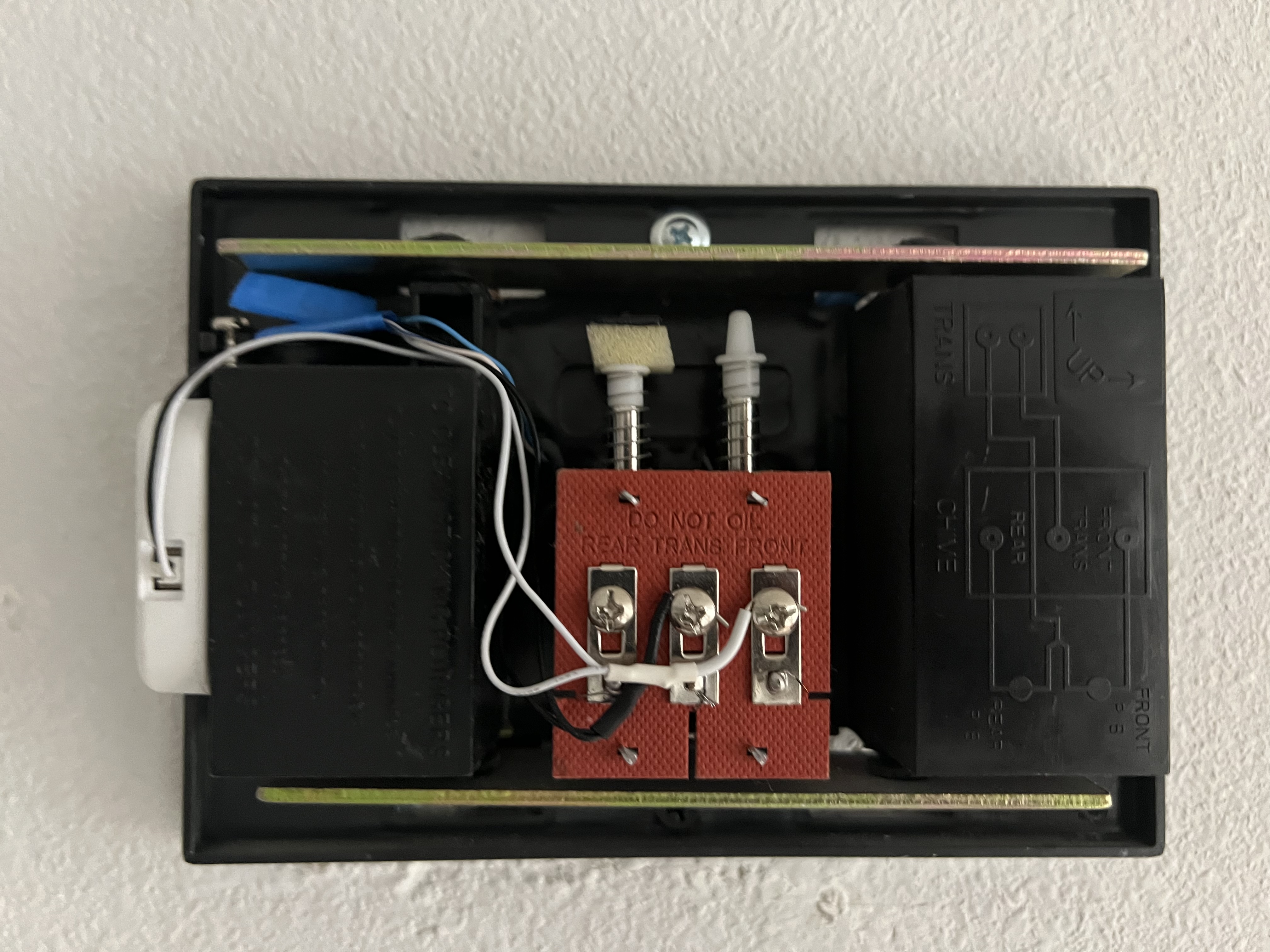

Thanks. One potential issue is that I noticed I’m still using the power module from a previous smart doorbell. I don’t think this is what caused this issue, but could you provide guidance on how I can replace this with the ADC module?

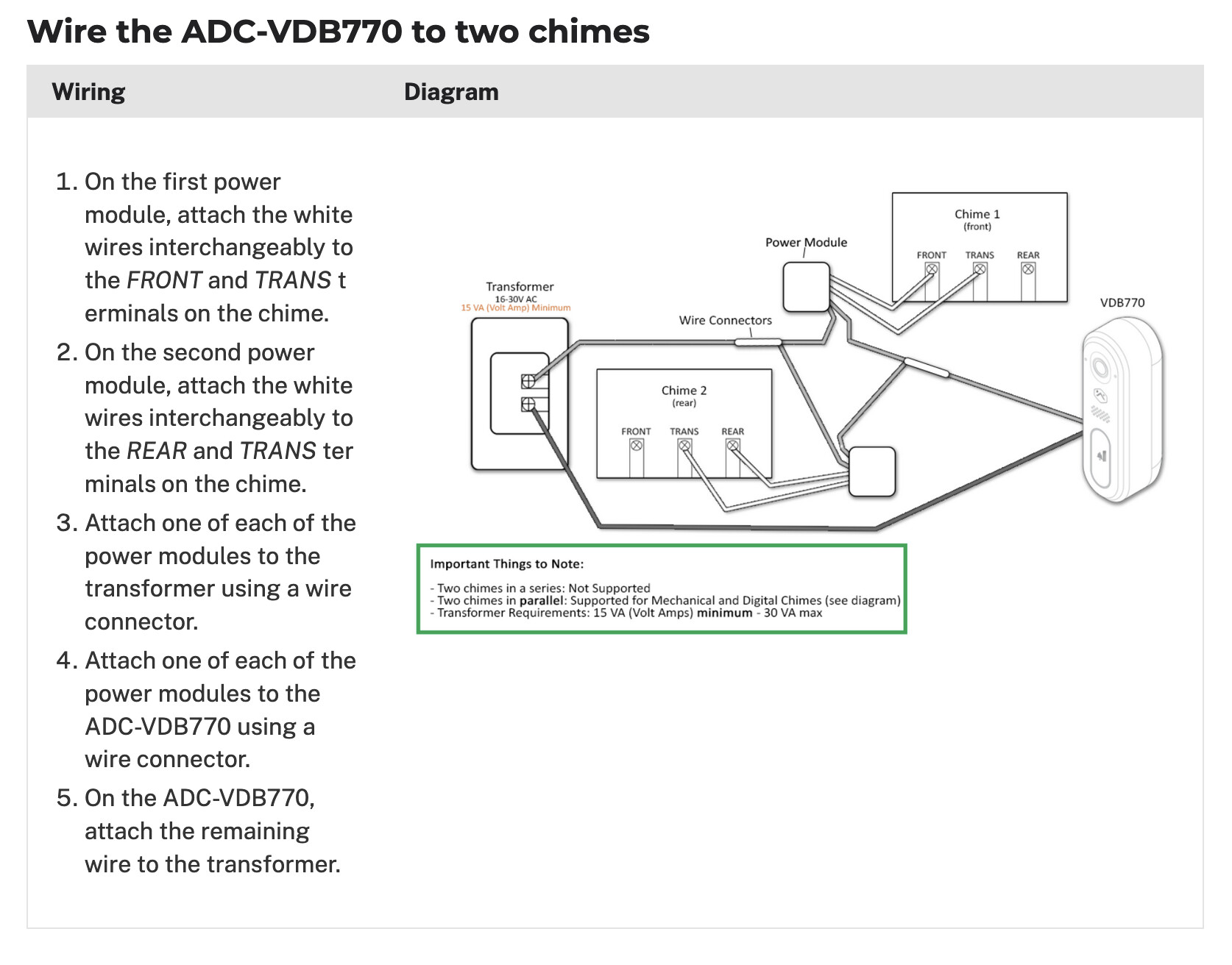

My 2nd chime does not have a power module and it seems that ADC requires one on all chimes. What should I do about that? Will I be fine without a power module on that chime? The previous doorbell was professionally installed so I would assume this configuration is ok?
Yes, you will need to use the Alarm.com VDB770 power module, and if you have two chimes connected to it there are specific instructions and two modules are required. See below for instructions on how to wire it:
