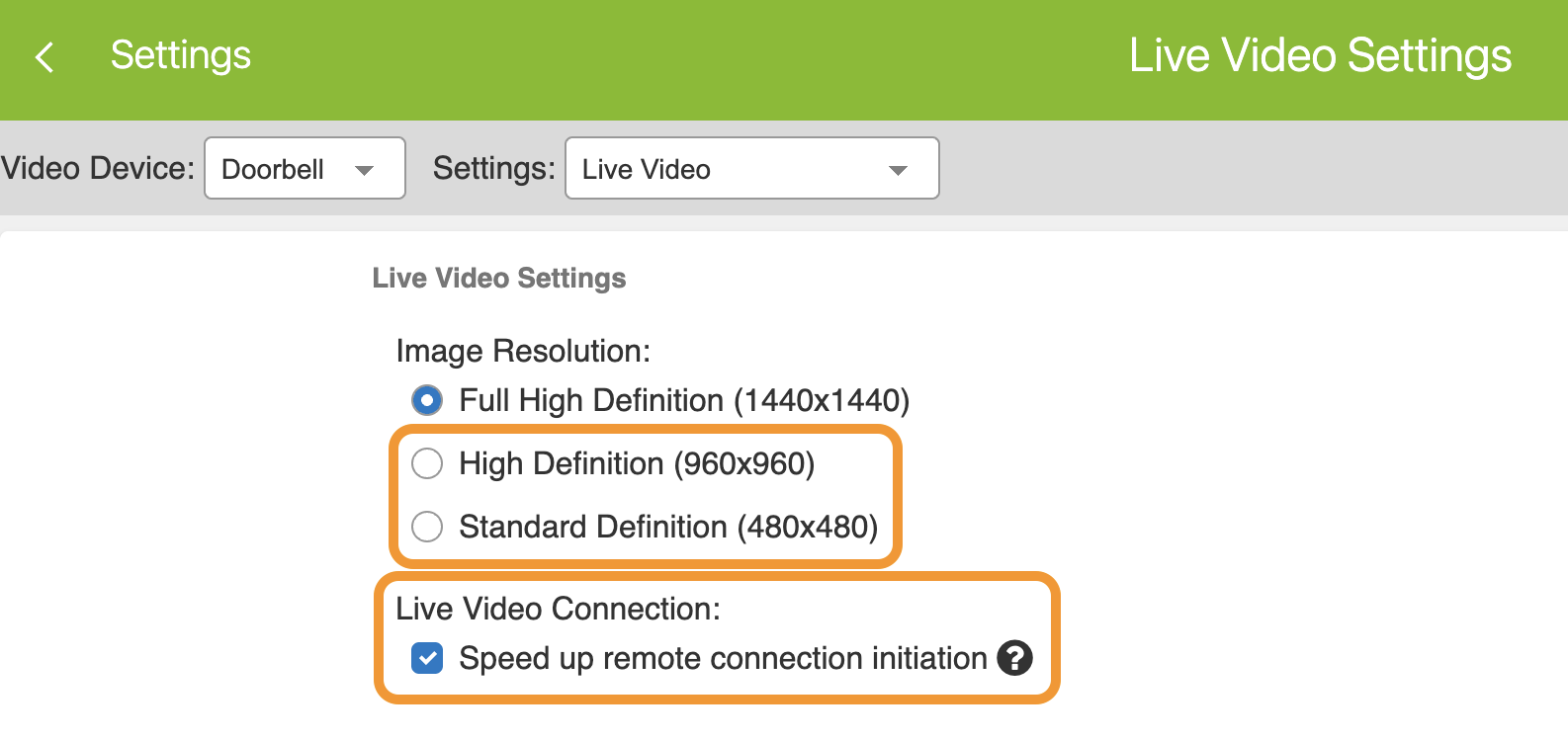

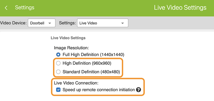

What happens if you uncheck the Speed up remote connection initiation setting? And/or if you reduce the Image Resolution?

  4. I tried various combinations of the “Image Resolution” and “Live Video Connection” options, but none of them made a noticeable difference.
