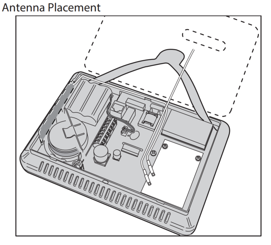

Can you take a picture or clarify how the antenna that is supposed to be inside the GC2 is supposed to lay. The manual is not clear. It can’t fit flush against the side and the instructions show it at an angle which doesn’t make sense to me
There is an image in the manual that shows the orientation, but it is not very precise I agree. From experience, on some older GC2s the manual’s instruction is not even possible due to the way the plastic housing is constructed.
There shouldn’t be a bunch of extra cable in the panel housing when closed up, so laying it flat in the middle of the panel will usually work on order panels, sort of next to the module.
