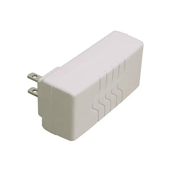

It uses the QR0051-840 power supply. A picture of it is on the manufacturer page here. Do you see that anywhere?
I don’t see it anywhere, but there is a red and black wire coming out of the wall where the mount is.
It could be in several different spots. Is your panel near an outlet? The wire could hav been run to the nearest outlet or to a different part of your house.
Popular spots for these could be a closet, equipment/server room, attic, or garage.
If you are not able to find it, you may need to reroute the wire to a nearby plug and install a new transformer.
