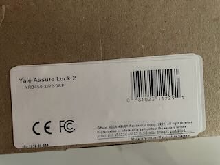

Santa brought us another Yale keypad lock, just getting around to installing.
