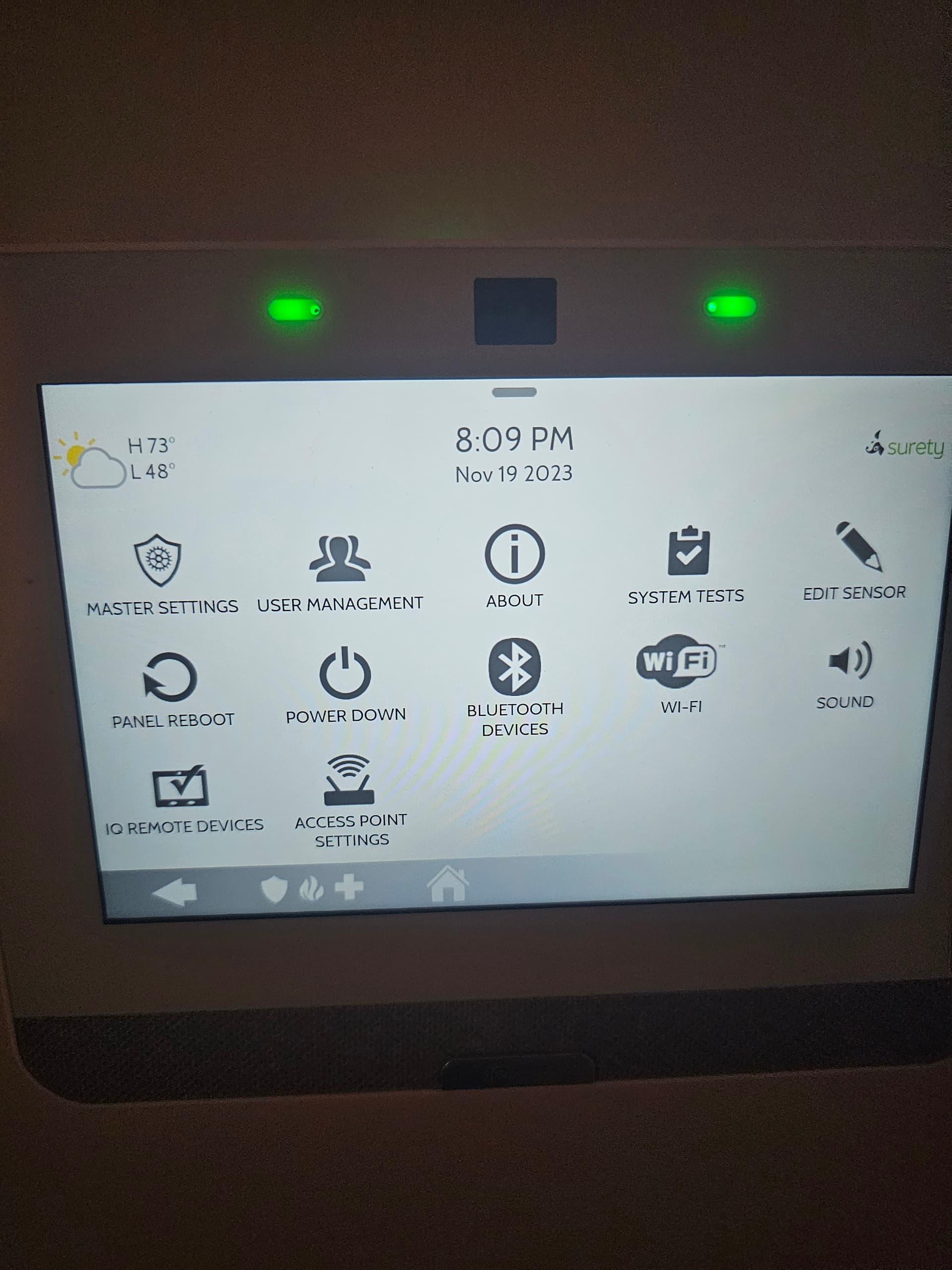

I don’t have an installation option when i sign onto my panel
That is the master settings, looks like you used your master code. When you click on advanced settings you want to use the installer code not your master. Try 1111 that’s the default installer, if not try 2222 for default dealer code.

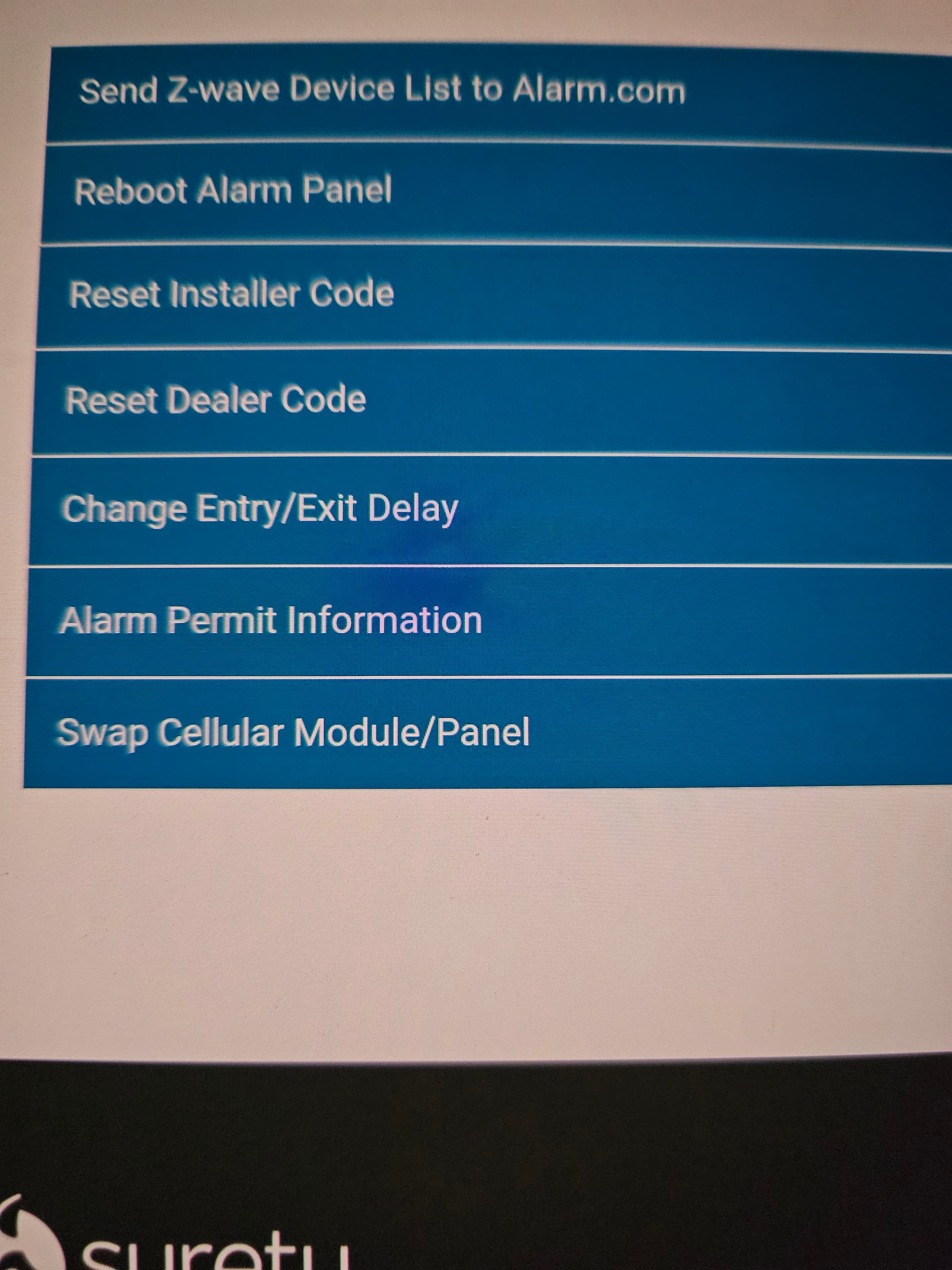

Perfect! Since the system was previously ran by ADT they use their own installer and dealer info, but you can easily reset both installer and dealer codes to default from your customer portal. Log in at My Account - Surety , go to system manager, log in using your alarm.com password. Once you’re there there under “My Alarm System” you should have options to reset both installer and dealer codes.
Once you do that, you should be able to program your sensor following the steps I provided previously.
It should look like this
