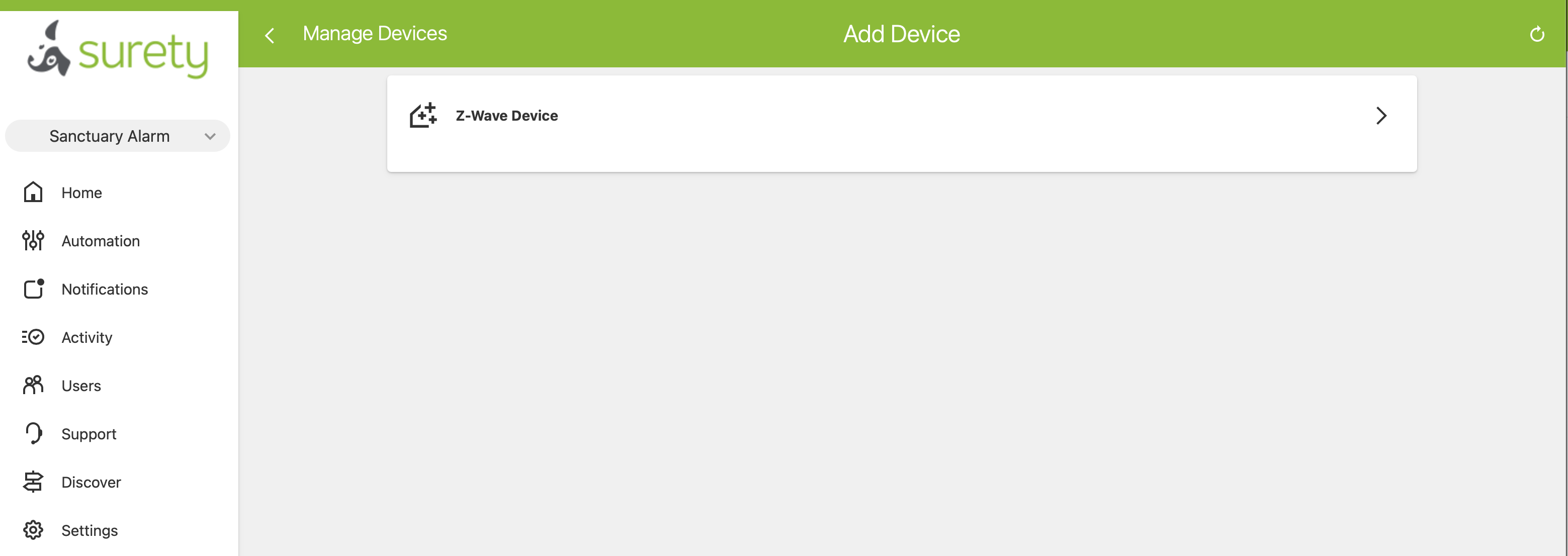

In the past, there was a way to setup and add devices via the web portal by choosing device type and using their MAC address. I can no longer find this anywhere. Can anyone provide some insight as to why I am having so much difficulty adding them? The only option both the web and mobile app interfaces have is “Z Wave device” (see attached image) and then after clicking the Next button, it just hangs forever at the “Automation Devices Wizard” searching and never finds anything.

Looks like you are enrolled in the Surety Alarm service plan. This does not include integration/control of video devices.
If you are looking for home security control with video, you can add video add-ons to your account, or switch to the Surety Protect service plan.
Changes to your service plan are made through the System Manager feature of your Surety account.
This process can be done at anytime.
Once video has been added, the Video tab will show up in Alarm.com and cameras can be incorporated.
