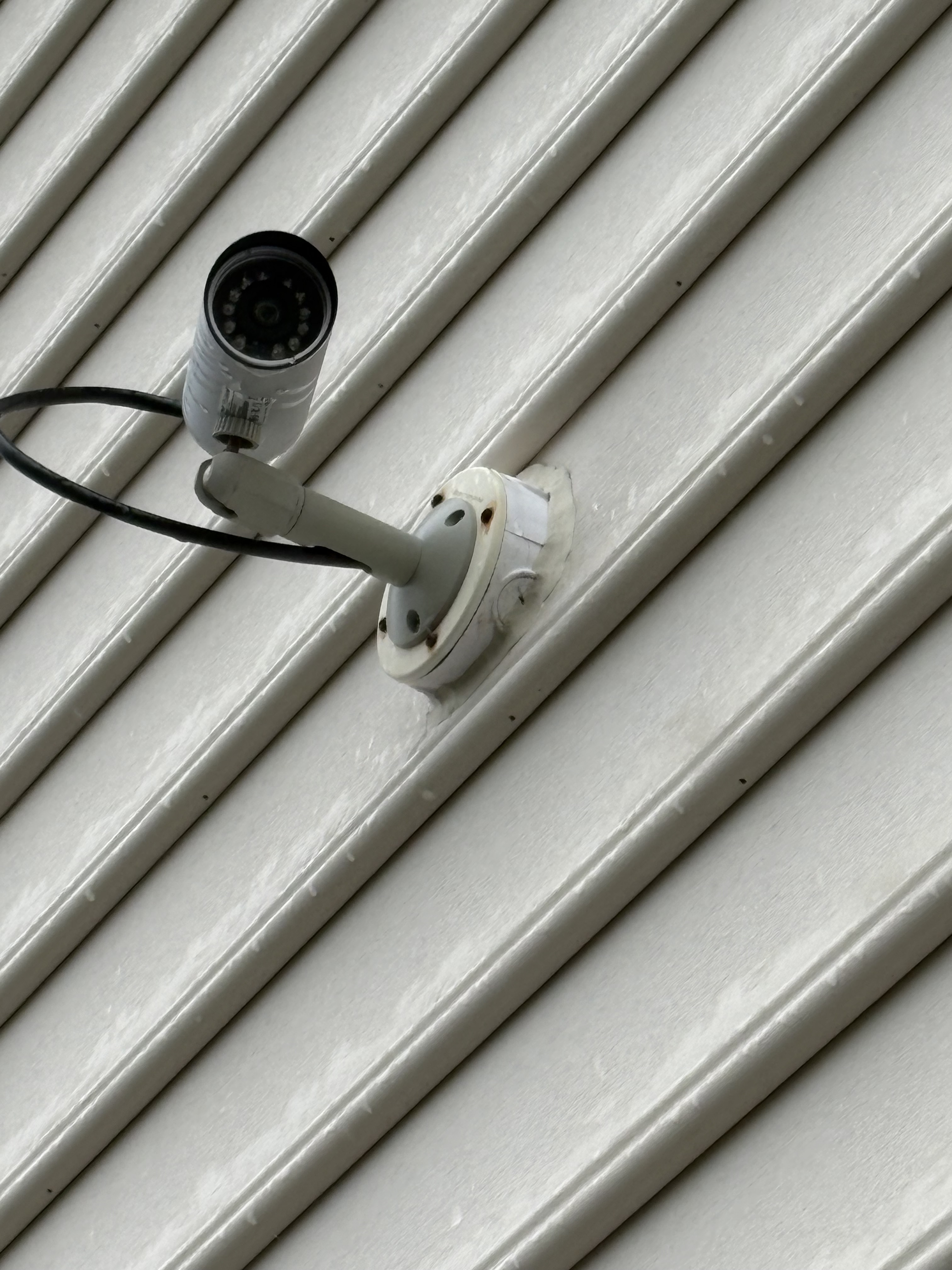

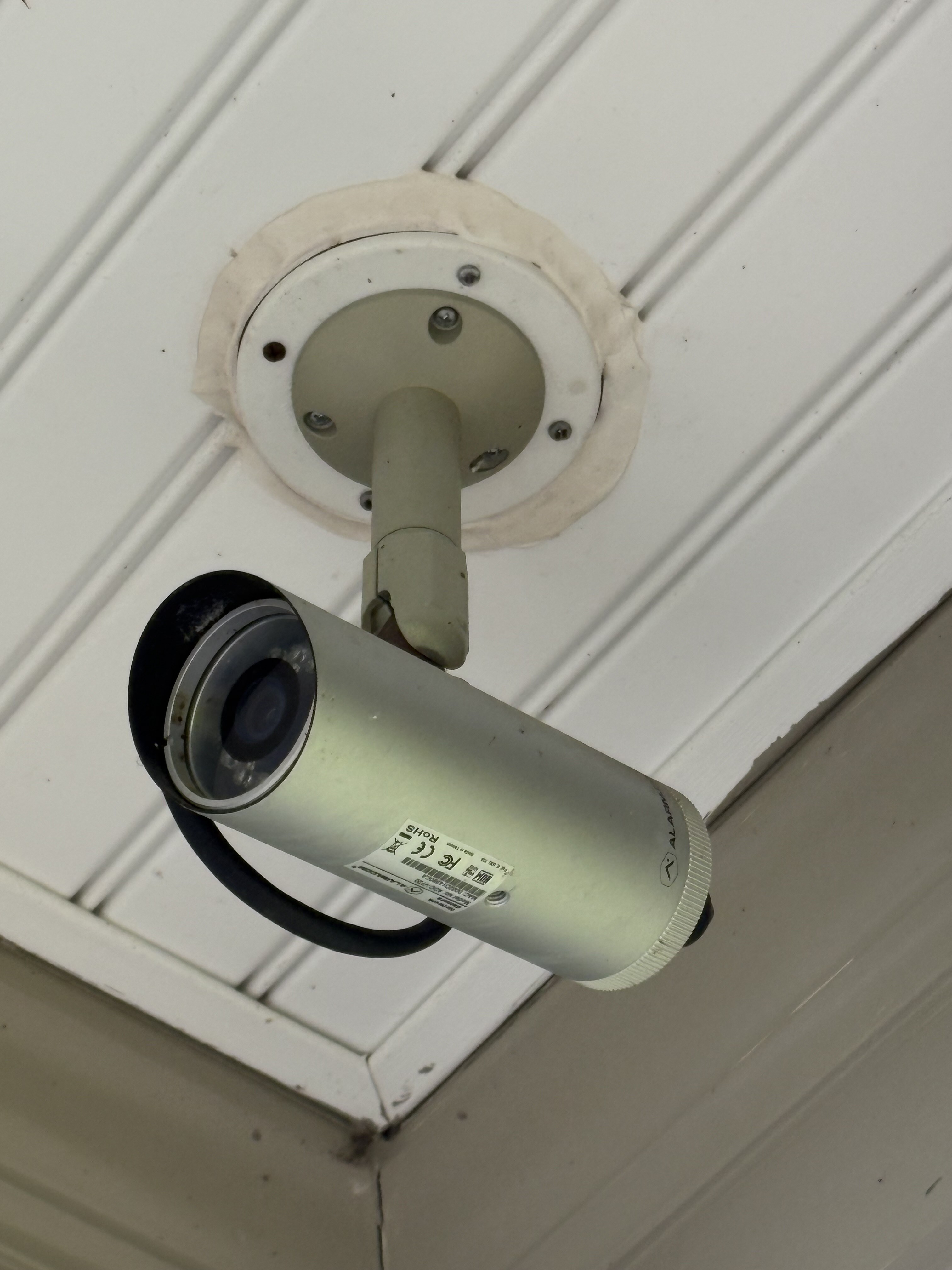

If I have a box for my current V720, does that need to be replaced as well along with the plate? I was hoping for a simple swapping of the plate, and I’m not sure if it’s easy to switch the box. If I do need to replace both item, is there any video instructions that I could watch to DIY?
Here are how 2 of my v720 is installed. They were installed by builder.
I am seeing that the backbox is shared for the V730 is share between these cameras:
V724X, VC727P, VC728PF, VC827P, V730, and VC8295P. The V720 not on the list so I cannot say it would work with it
