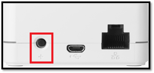

  2. Press and hold the black button on the hub until the ring starts to flash(about 20 seconds)(this resets the network settings but not the devices learned in)
