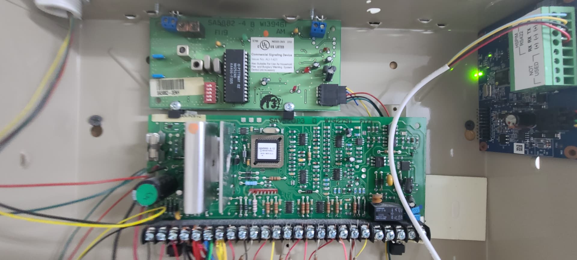

I have the following installed:
  • the Honeywell Vista20P for the main board.

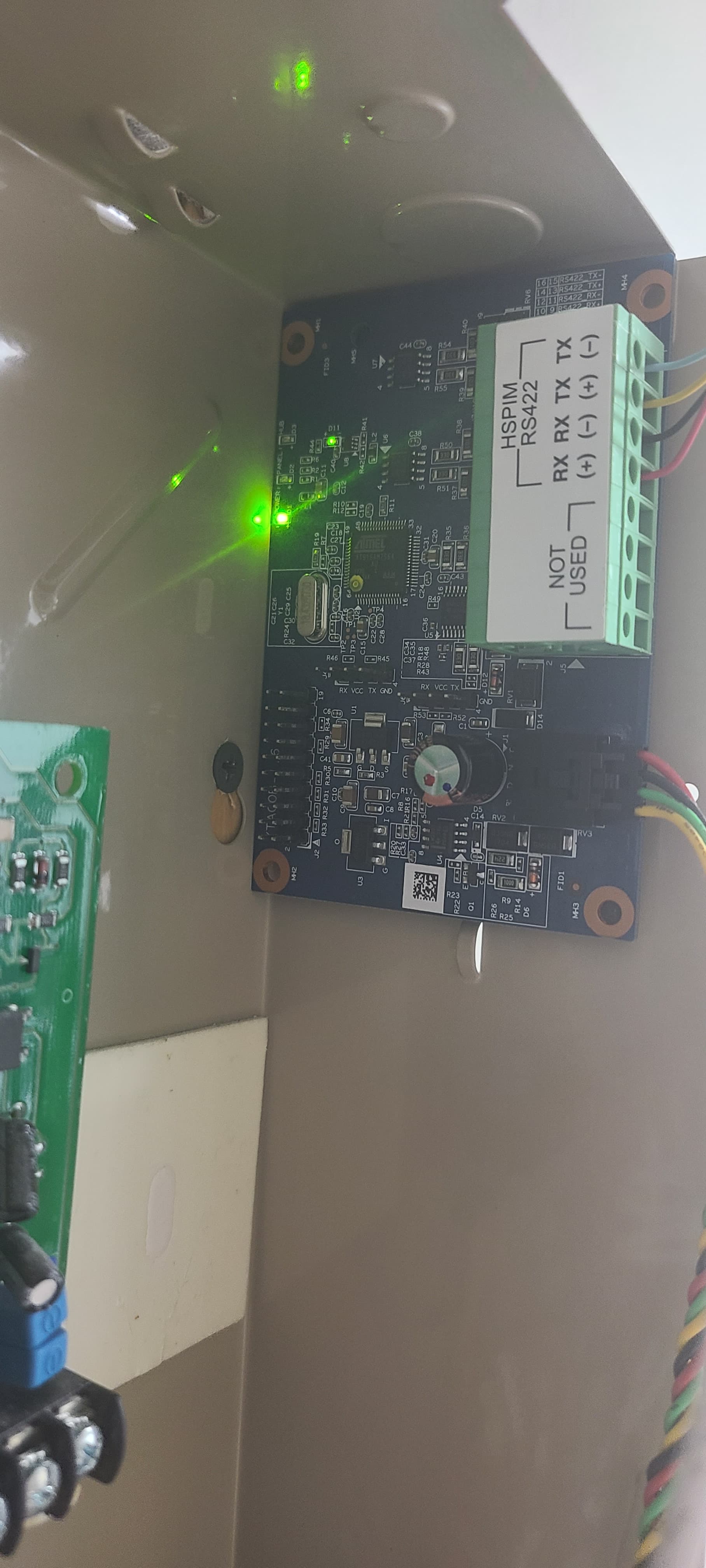

  • The system currently uses Resideo LTEXV-ADT for cellular and uses the ADT Pulse Gateway Netgear PGZNG1 Security WI-FI System Router to connect to the Pulse app with the ADT Honeywell HSPIM RS422.
  • Wireless receiver is the Honeywell Ademco SA5882

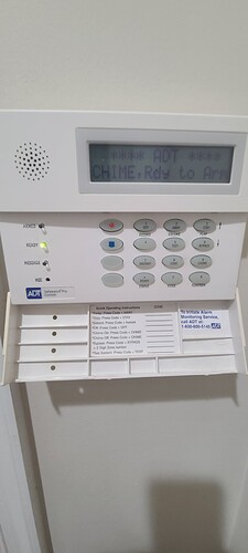

  • 2 safewatch custom pro keyboards, wasnt able to get the models.
My current installation:
It appears that all the sensors and equipment would work except I would need to buy a new prom and an SEM module, I need to buy a va20p prom and a ADC-SEM300-VT-AT
Any advice on where to buy the prom and revision would be appreciated.

Yes, those would be the basic steps, though a Prom upgrade is usually not required unless too old.
Disconnect the Pulse cellular/broadband communication devices before installation of the SEM.
I cannot vouch for any specific third party seller, though Vista is a popular panel and a number of vendors online offer parts.
Activation of your service on our website is a step by step process. Your new Alarm.com account is automatically created as part of activation.
You will need to know the current installer code of the system.

The ADT Safewatch Pro 2000 is incompatible with Alarm.com, but the Safewatch Pro 3000 is what you have and should be fine. The version you have is new enough to be compatible.
Nothing would change in terms of sensor compatibility as long as you do not disconnect your wireless receiver.
You can add more sensors whenever you want to.
Yes, if you have a plan that supports alarm monitoring (Alarm, Home, Protect, Complete) any compatible connected smoke or CO devices are monitored as well. Smoke detector monitoring is not separate from other alarm monitoring.
