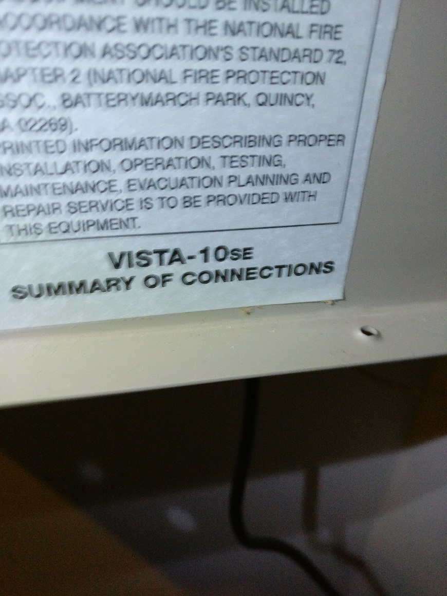

The main panel is a VISTA-10se

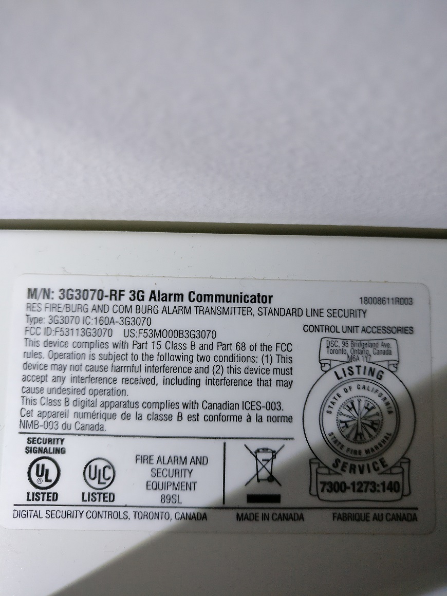

The cell box is a 3G3070-RF 3G Alarm Communicator (can’t open it to find serial/imei)

suretyDIY is an Alarm.com service provider. At this time, there are no Alarm.com compatible cellular communication modules for a Vista 10SE panel. The SEM (system enhancement module) requires 10P panels (I believe due to keypad addressing ability).
Switching would require a panel, communicator, and a way to use existing sensors.

PS - So there is nothing I can do with that existing cellular modem?
As your existing cellular module is not Alarm.com compatible, it would be unusable for service through suretyDIY.
