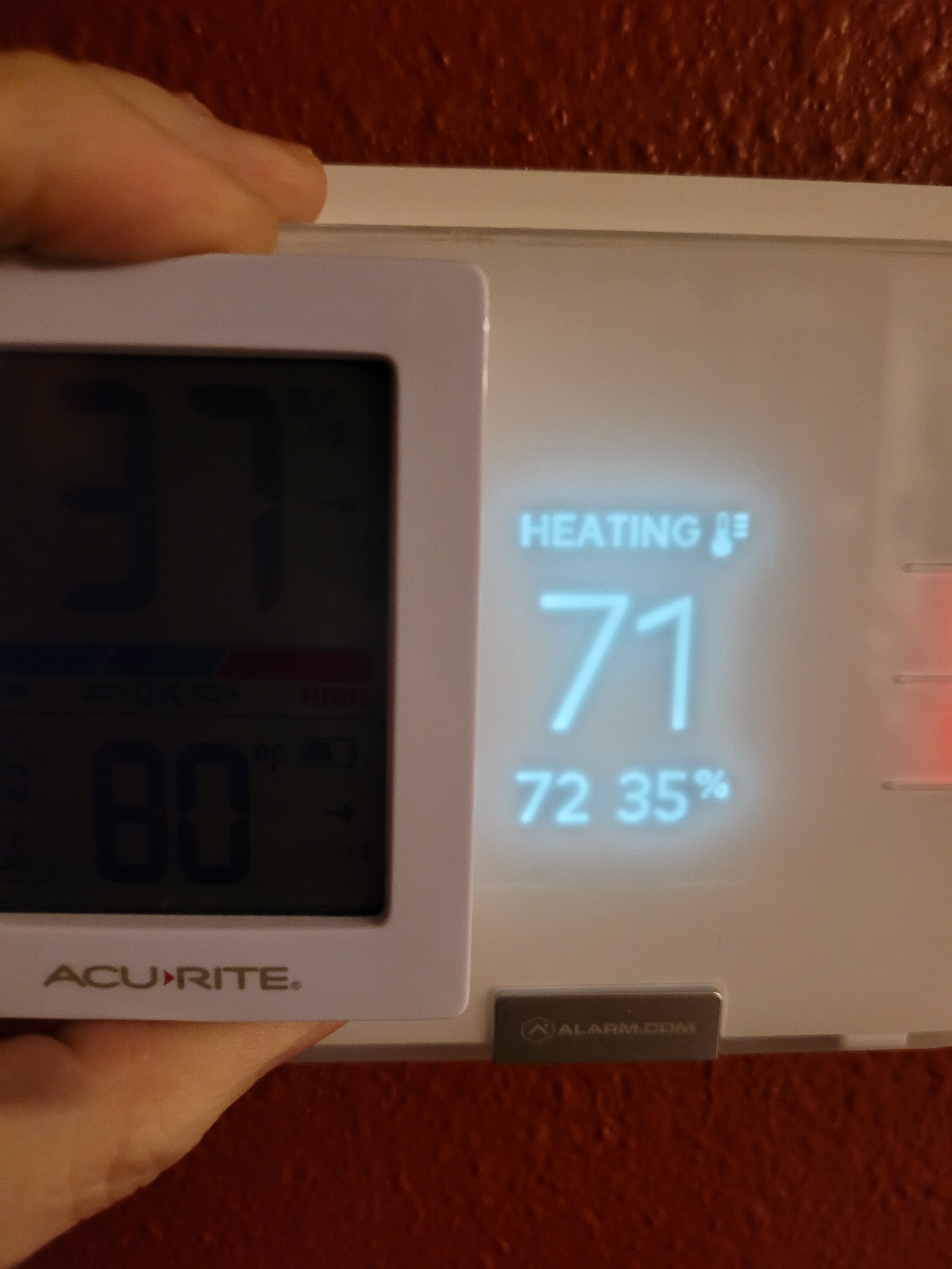

So, good news I guess, at least we don't have to keep waiting to see a result. Removing the C wire didn't help. Been running on battery only since last night and it was working, until 6PM tonight we were out for an hour and came back to the house at 80 degrees while the thermostat thinks it is 71 and is running non stop to the target of 72. Attaching pictures of before and after battery pull on the stat.
I can see that temp, and I am glad we got a definitive result, but it’s no less confusing. I am reaching out to Alarm.com for more info and providing them the HVAC model. It is extremely suspicious for more than one thermostat to experience this, let alone 4. There may indeed be some incompatibility at play.
