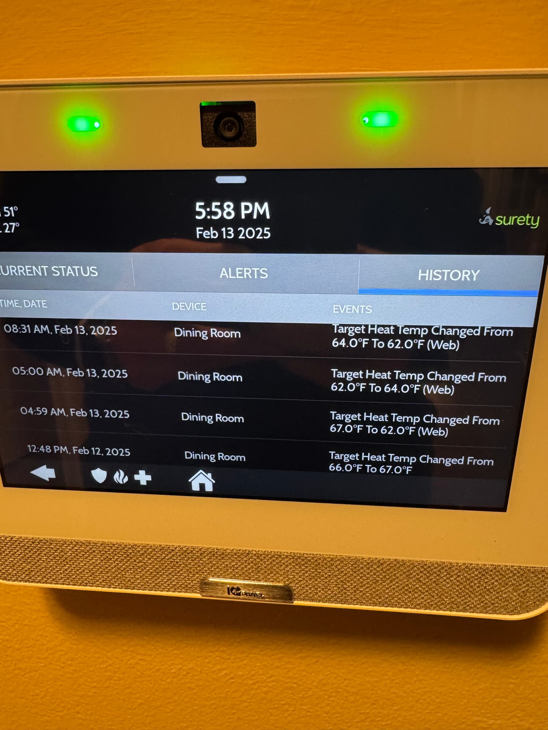

What I should have checked this morning was the device history. When I check it now I see the command going to the stat (pic below) at 459a (when I manually turned the schedule off/on). There is no command history for when the schedule should have fired (8pm 2/12). Not sure this means anything… just interesting.
