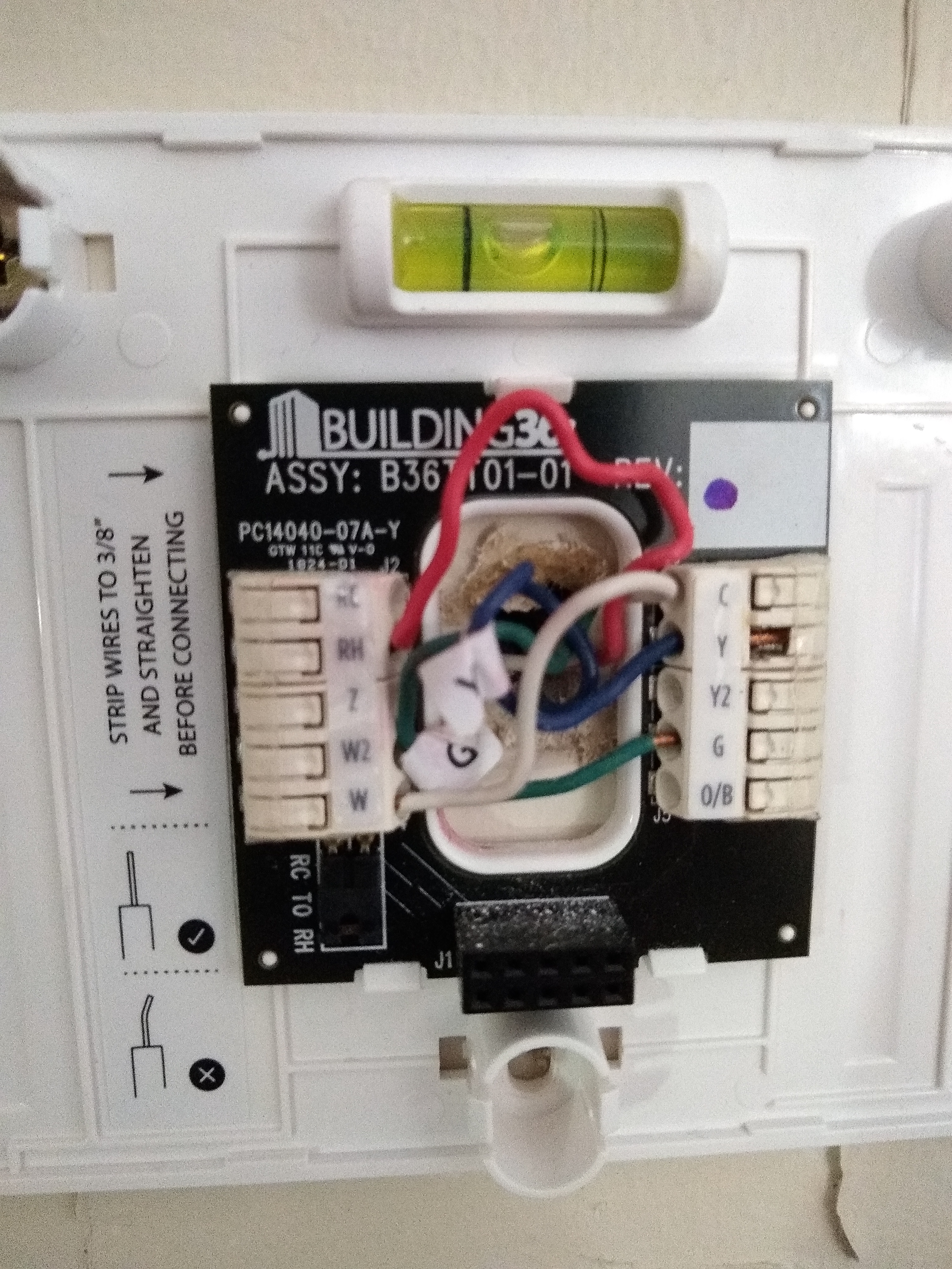

Can you provide a description of the wiring you are using at the tstat?

The wire connected to Y terminal is going to be the one that controls cooling on a standard furnace and air conditioner unit.
It is hard to tell from the photo, but it looks like the Y wire may be bent pretty sharply or its sheath damaged. Can you confirm whether the sheath is intact all the way up to the terminal? If not you may be experiencing a short on the wire
