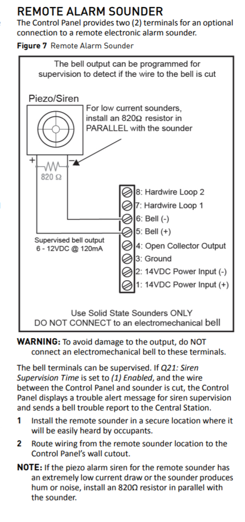

There is a way you could reuse hardwired sirens if they are low current piezo sirens. See the attached image pulled from the 2GIG panel manual. It shows how to use the bell output on the 2GIG panel.
The 2GIG panel will not be able to drive a high current siren or a speaker, just piezo sounders. (These are most common though)
