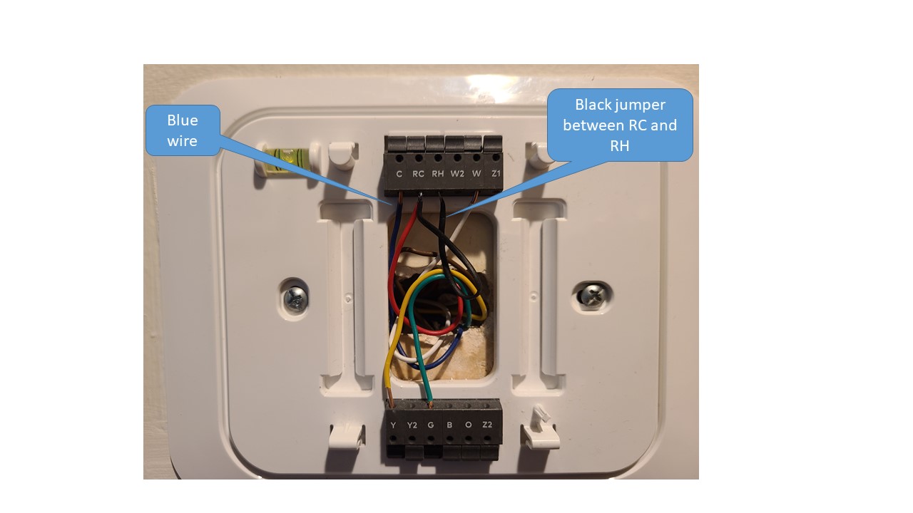

I’ve attached a picture showing my wiring for the T3000 which works great and includes the triggering of the display with the motion sensor feature. I put a jumper between RC and RH. Hope this helps.
