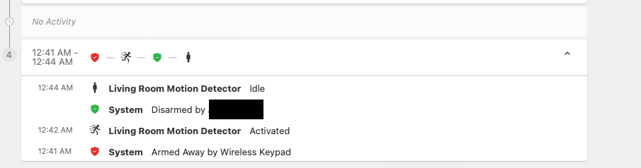

I’m trying to understand why my Alarm system 2GIG GC3 (firmware version 3.2.6) decided to automatically initiate Armed Away in the middle of the night at 12:41am without my consent.
The activity log shows that it was initiated by Wireless Keypad… but I do not have any wireless keypads associated to my alarm system.
Can anyone explain how this could have happened? Thank you.
You do have a device labeled wireless keypad which reports as being a touchscreen secondary keypad. It looks like it is programmed using the equipment code for the 2GIG SP1 touchscreen secondary keypad.
The panel reports it was installed 12/29/2020 2:20 pm
That is the device where the arming was triggered.
