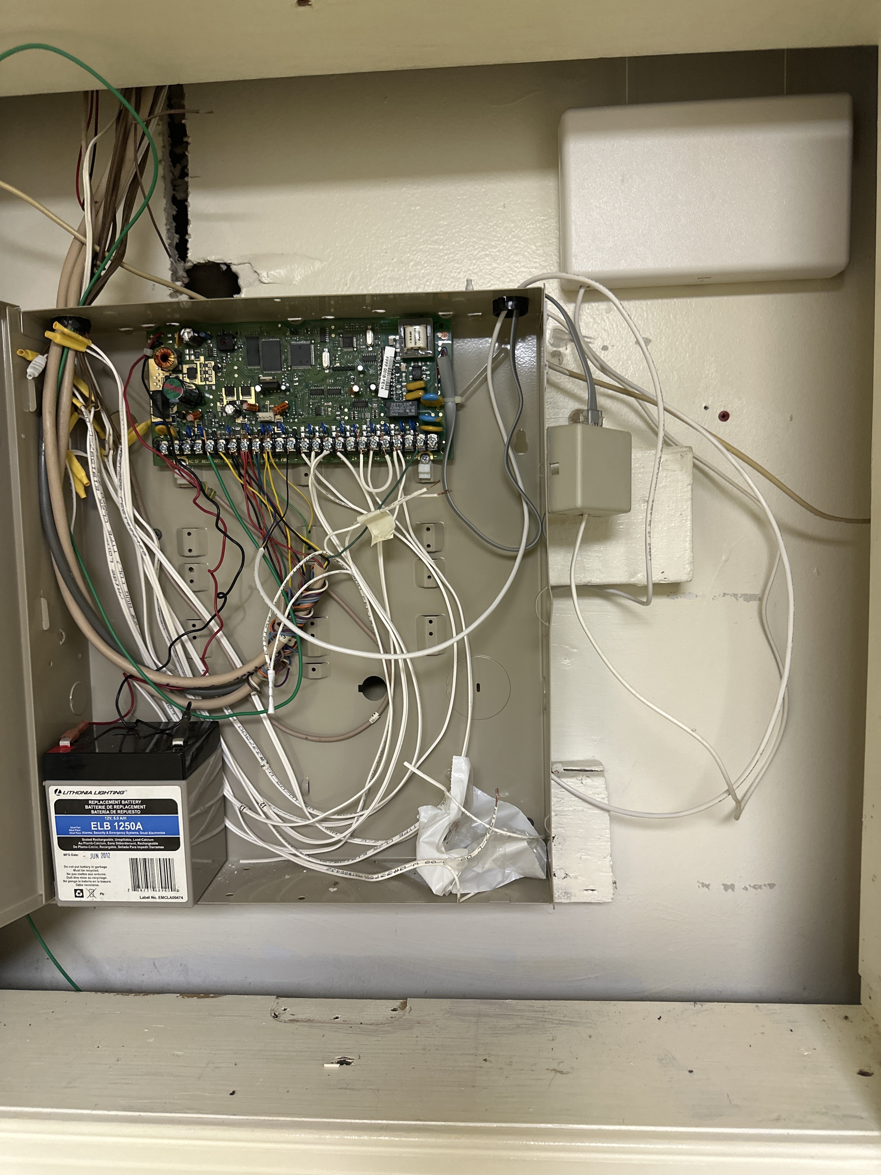

Would like to switch from a wired security system installed by brink and now on adc.
Attaching pics of the central panel with the wired sensors. Can we convert this to a Surety
system?

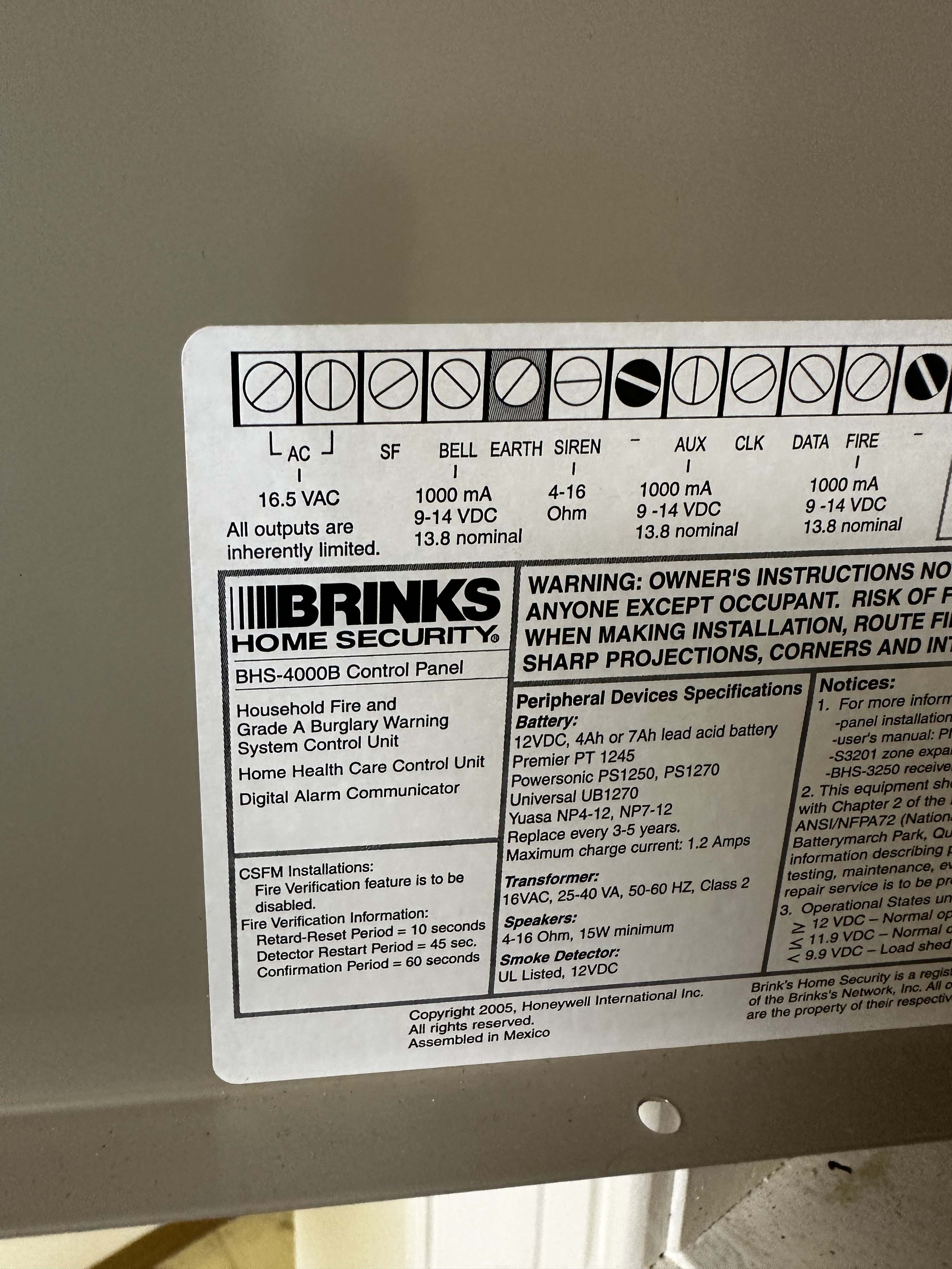

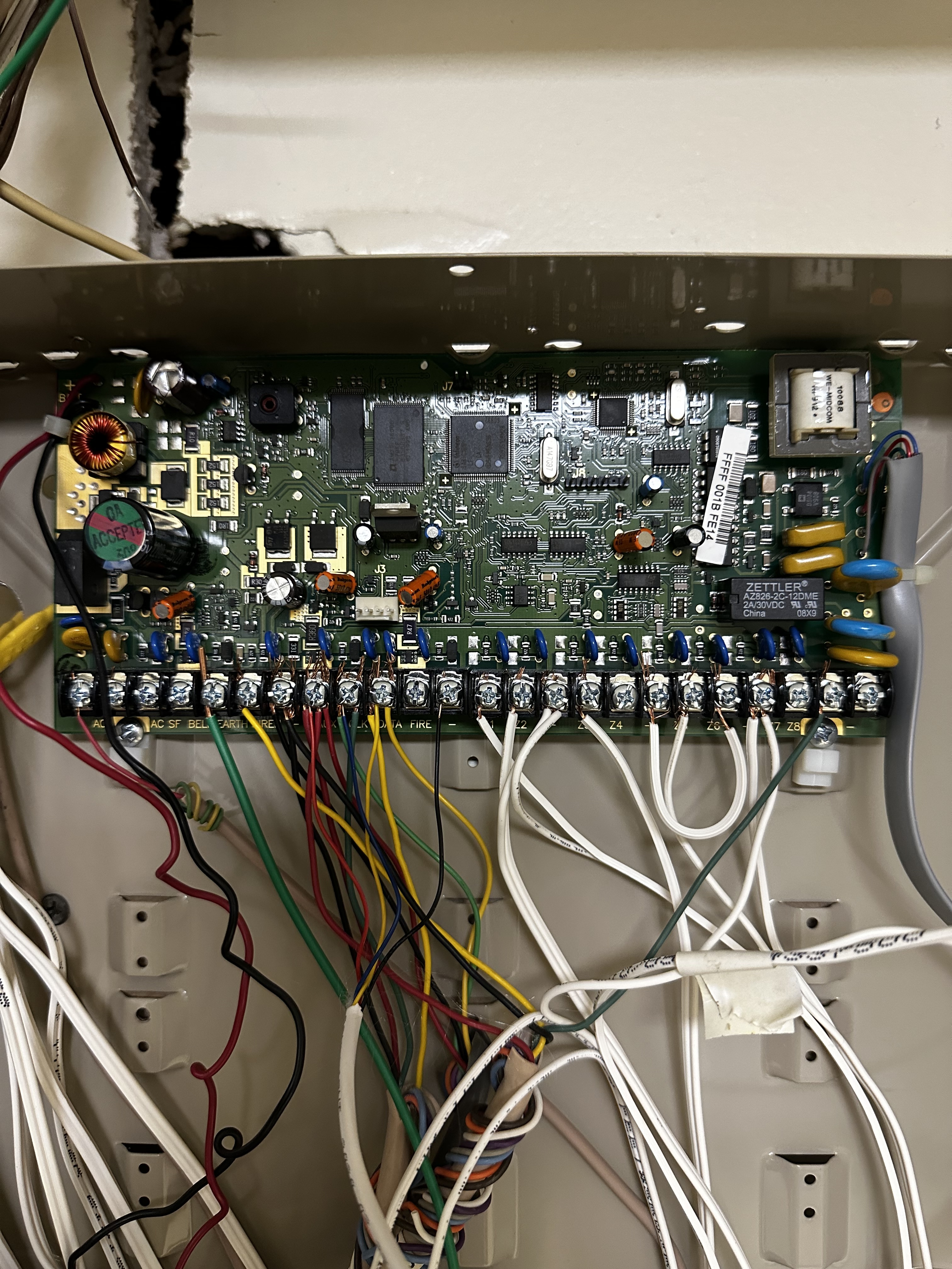

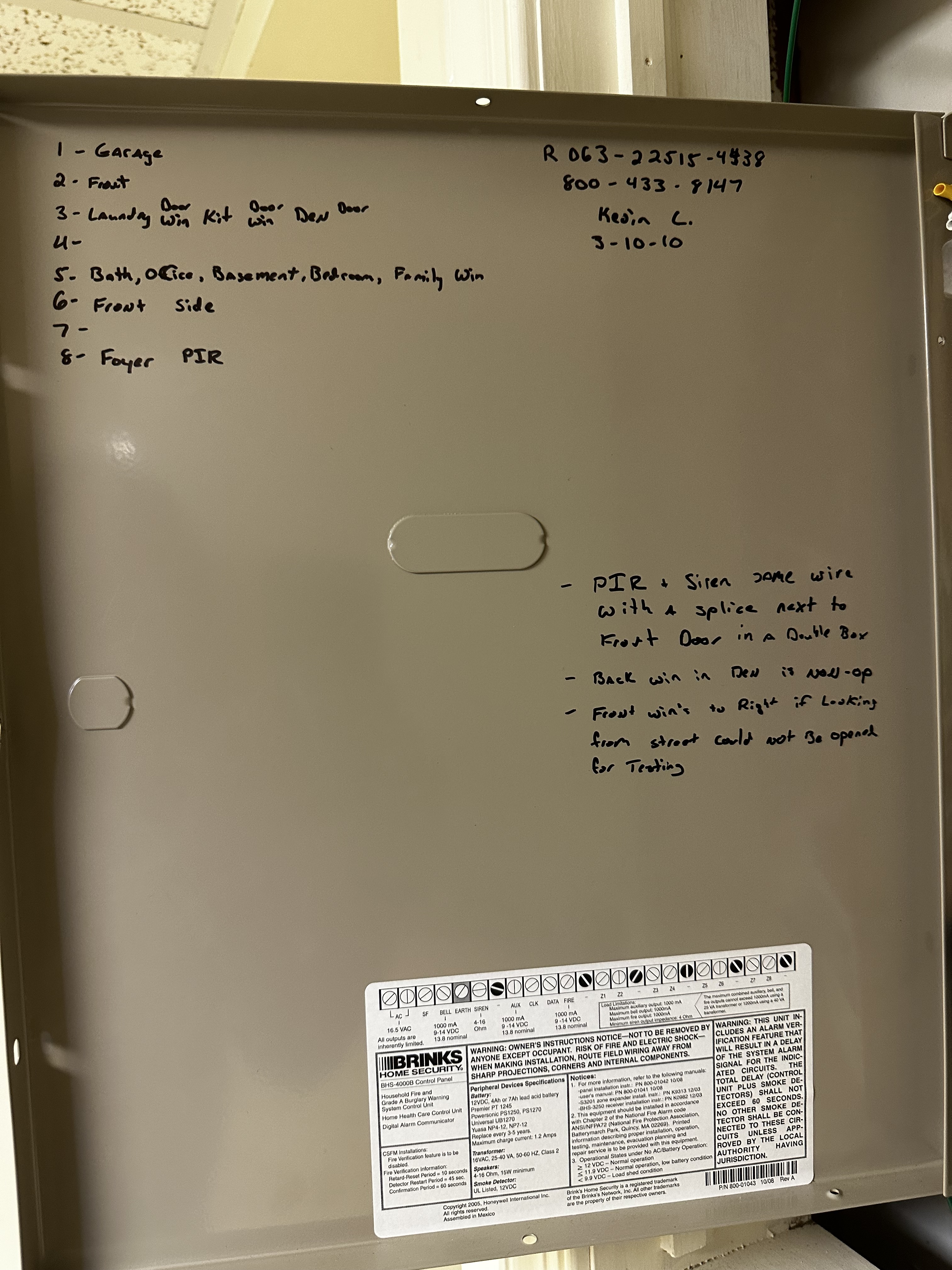

I am not able to positively identify the panel and capability on those images. What is the model number of that alarm panel you have? A photo of the labels on the interior of the front cover may assist.
The BHS-4000B is not a compatible panel, but you can reuse wired sensor zones with a different panel.
We sell the IQ Panel 4, available here. A hardwire to wireless translator like the Hardwire PowerG can then be used to monitor the wired sensors you have.
That’s great. We will do that
