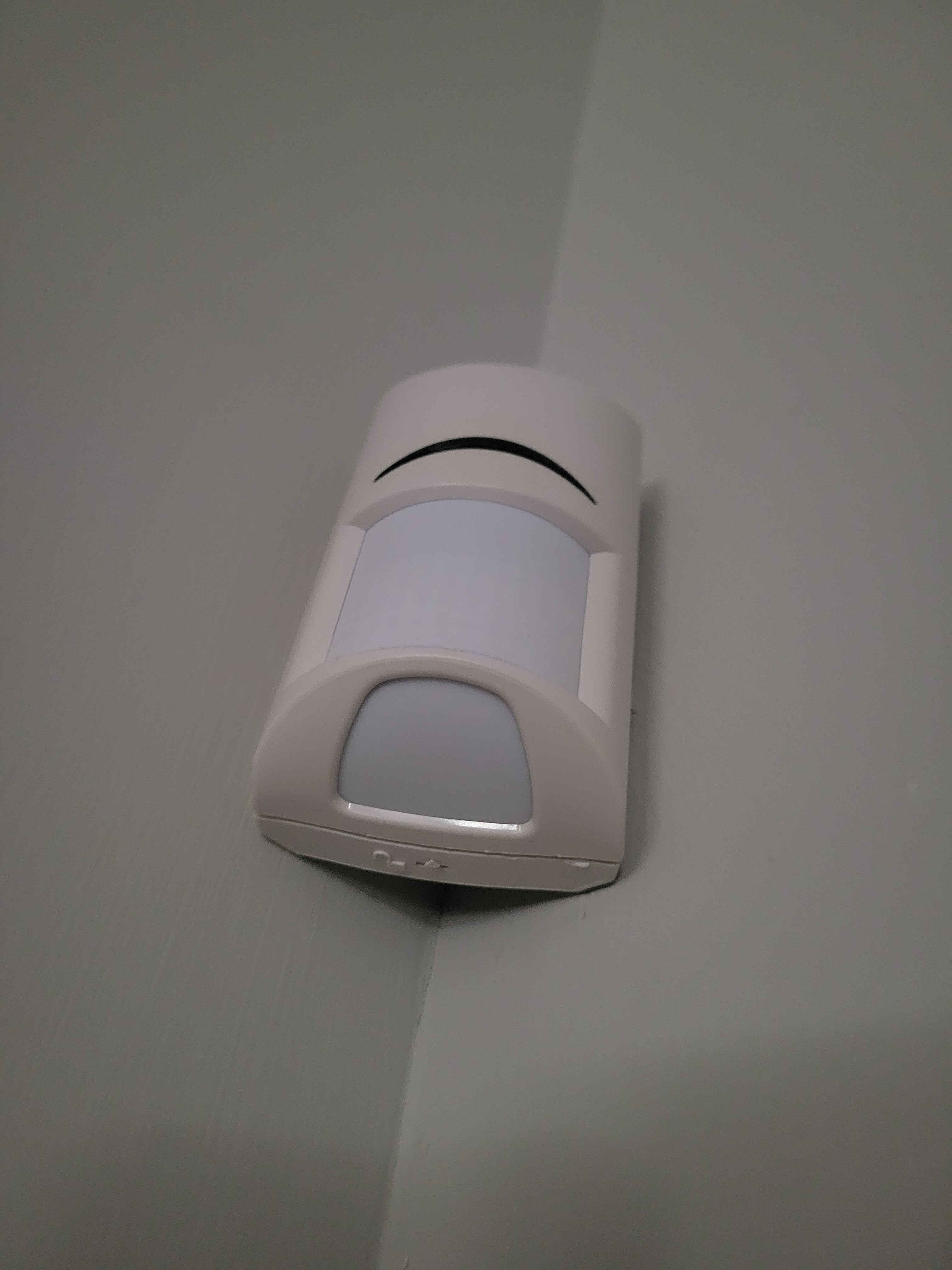

Can you send us a picture of the detector?
That looks like a Bosch Blue Line. Those do have a sensitivity adjustment on them.
On the bottom is a lock; you’ll need to use a screwdriver and turn counterclockwise to unlock it and slide the front part of the motion detector down to take it off.
Inside, there will be places to adjust the various sensitivity settings on the detector. You can refer to the manual below for information on how to adjust the settings to your needs.
