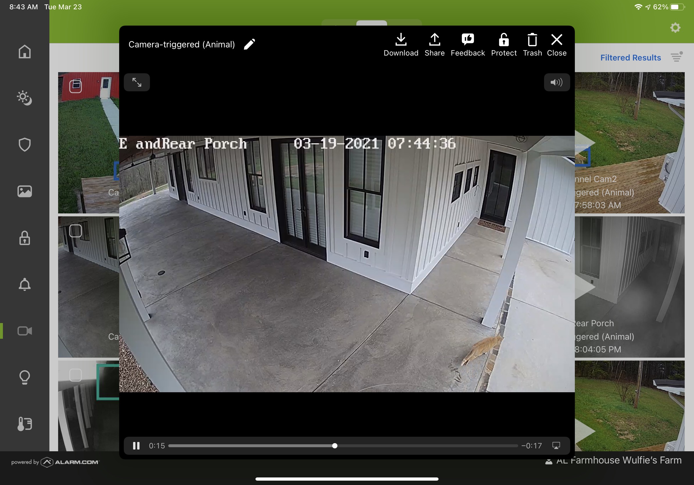

I have several VC826 Dome Cams. They are clear during the day but blurry at night. I have removed and cleaned the inside of the glass dome several times to no avail. I used windex, even used alcohol and acetone. Makes it different but can not get rid of blurr everywhere.
Here is example . On some its worse than this at night but fine in day

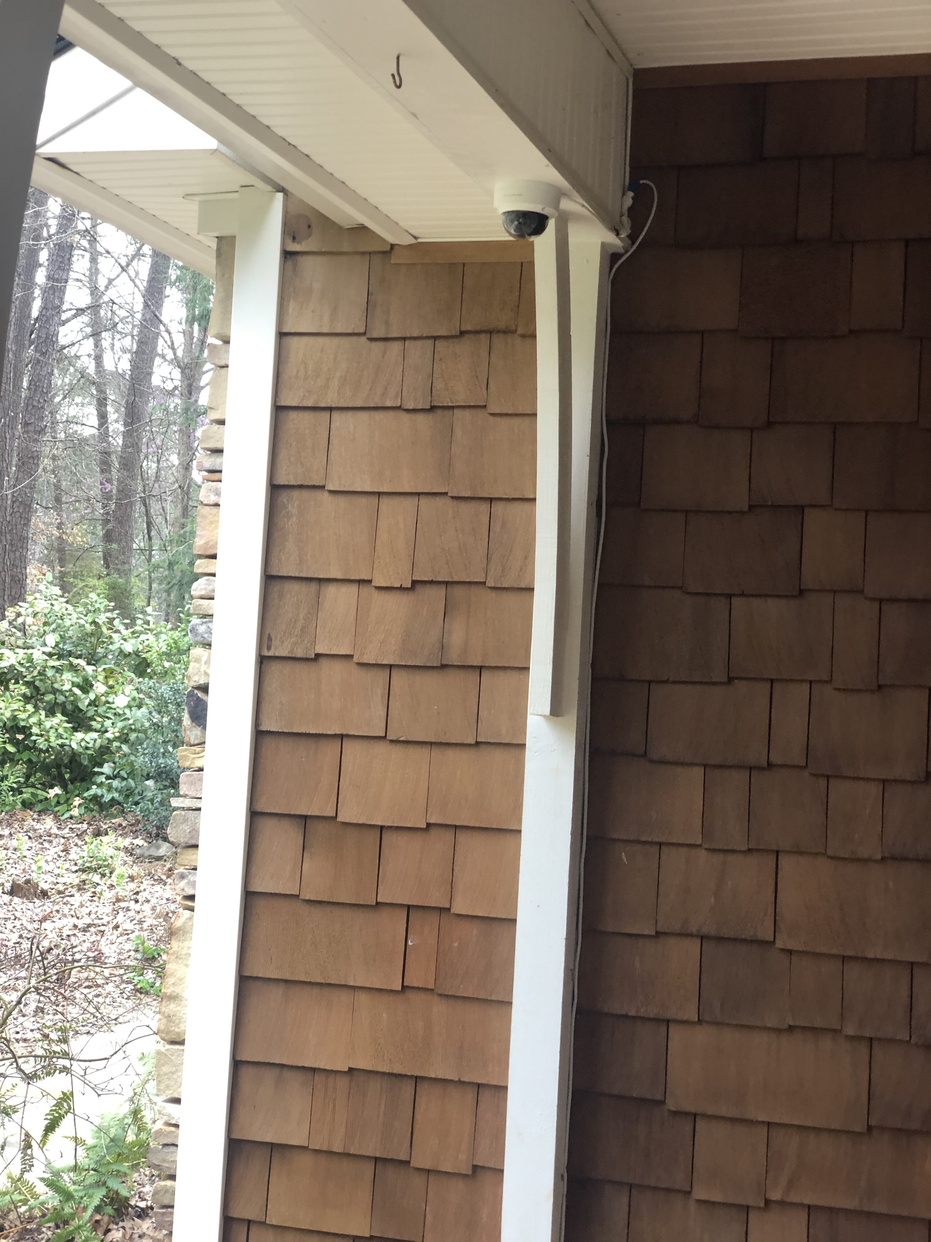

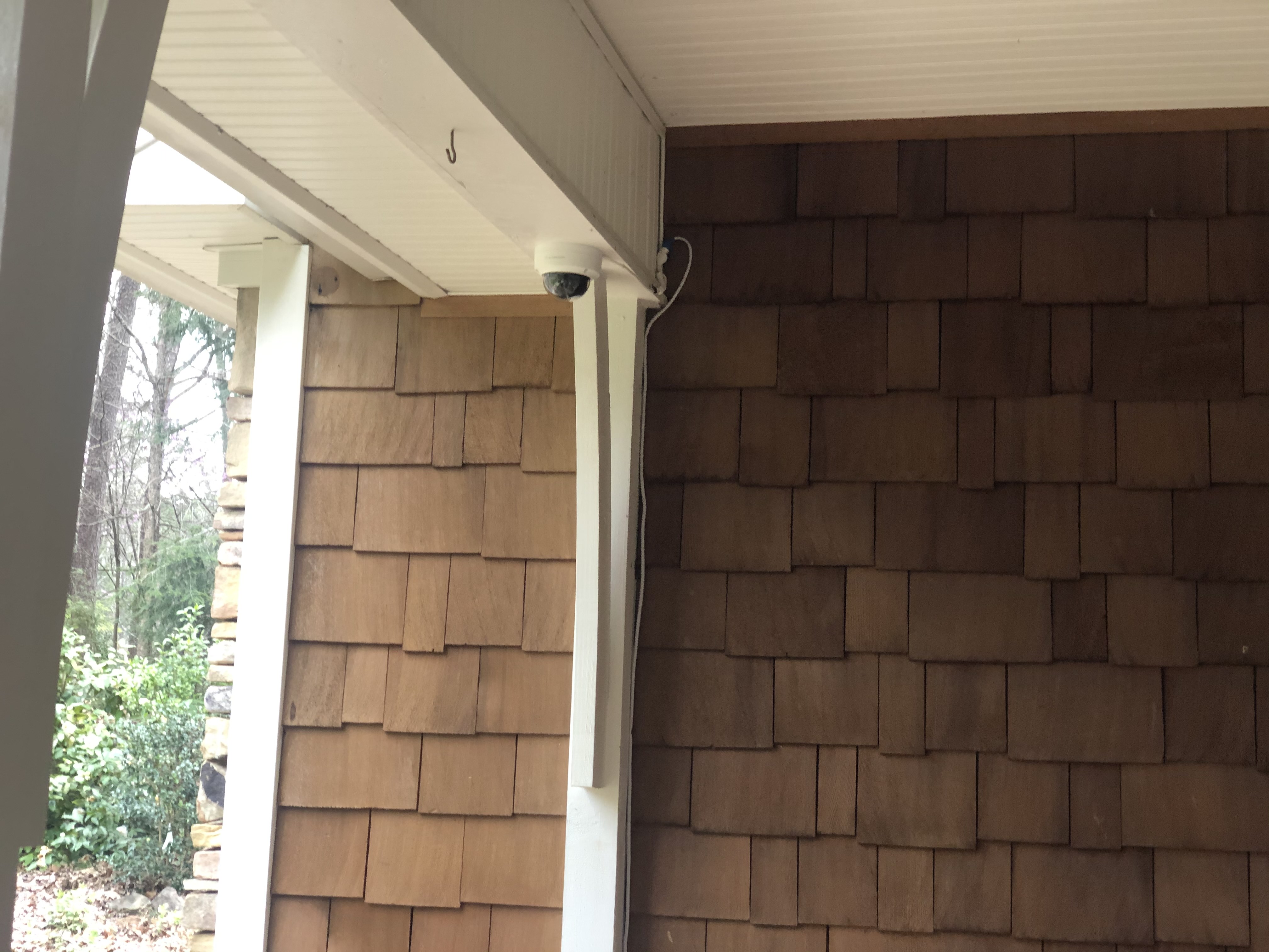

If it is, double check to be sure the camera is sealed securely. How is the camera mounted? Is it under an overhang, on a wall? A photo of its installed location may help.
Yes they are sealed. When i cleaned them i checked the seal / oring.
All but one are under roof of porches far in from the roof.
Here is pic of one’s installation

Alright, yeah just checking if water might get inside.
Double check at night for condensation, and double check to make sure there is no plastic film on the dome or lens. It would similarly be hard to tell during the day and exaggerated at night due to IRs.
