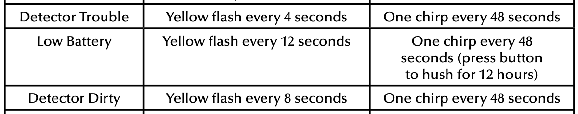

Do the smoke detectors themselves beep and flash their status LED? There are other conditions for some smoke detectors specifically that will cause an Offline supervisory trouble, like a dirty sensor status. The frequency of local LED flashes while a sensor beeps tells you what the status is. From the IQ Smoke Detector manual:
