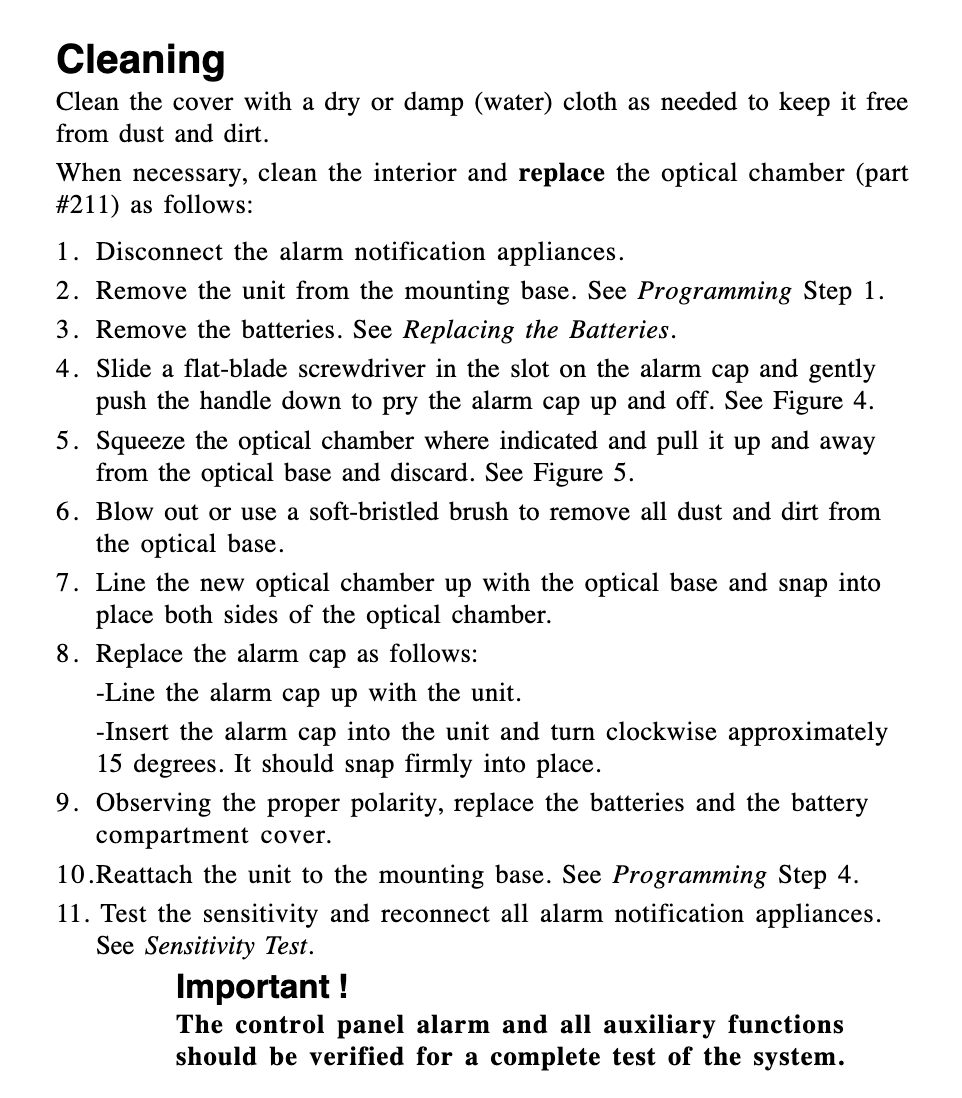

It is an Interlogic TX-6010-01-1. It is not beeping. I will have to check the date code. Is there anything on this model that can be cleaned?
