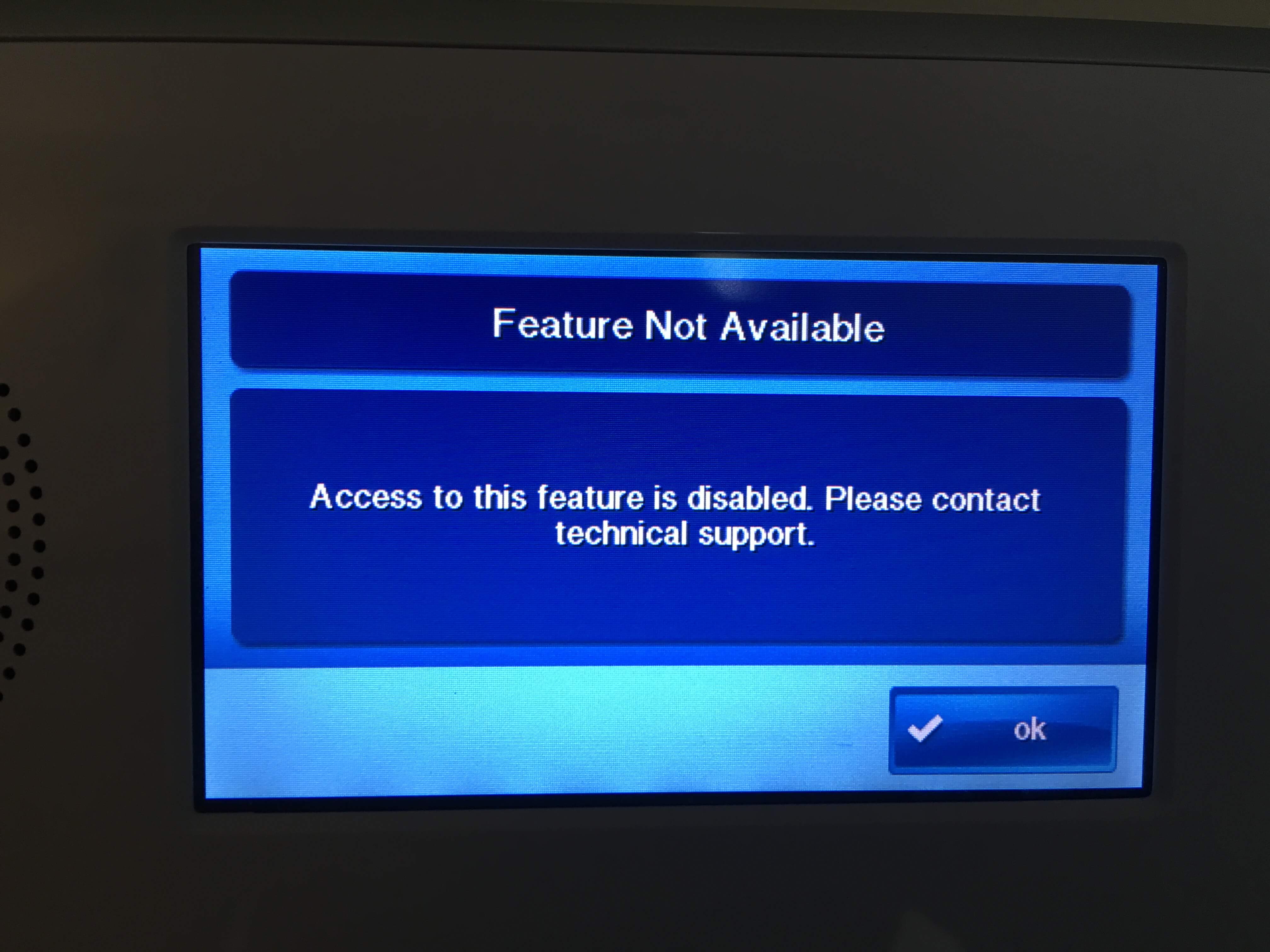

this has been happening for about 3 weeks since we moved the sensor during a remodel project…it is not close to the original location…I tried to disable the sensor…but got this warning

Well that’s weird. I just sent a command to unlock for you. (Q44 in programming) Try again in about 5 minutes.
OK, that worked…I removed the malfunctioning smoke detector from the system…what’s my next steps? Do I need to buy a new one or have it looked at?
