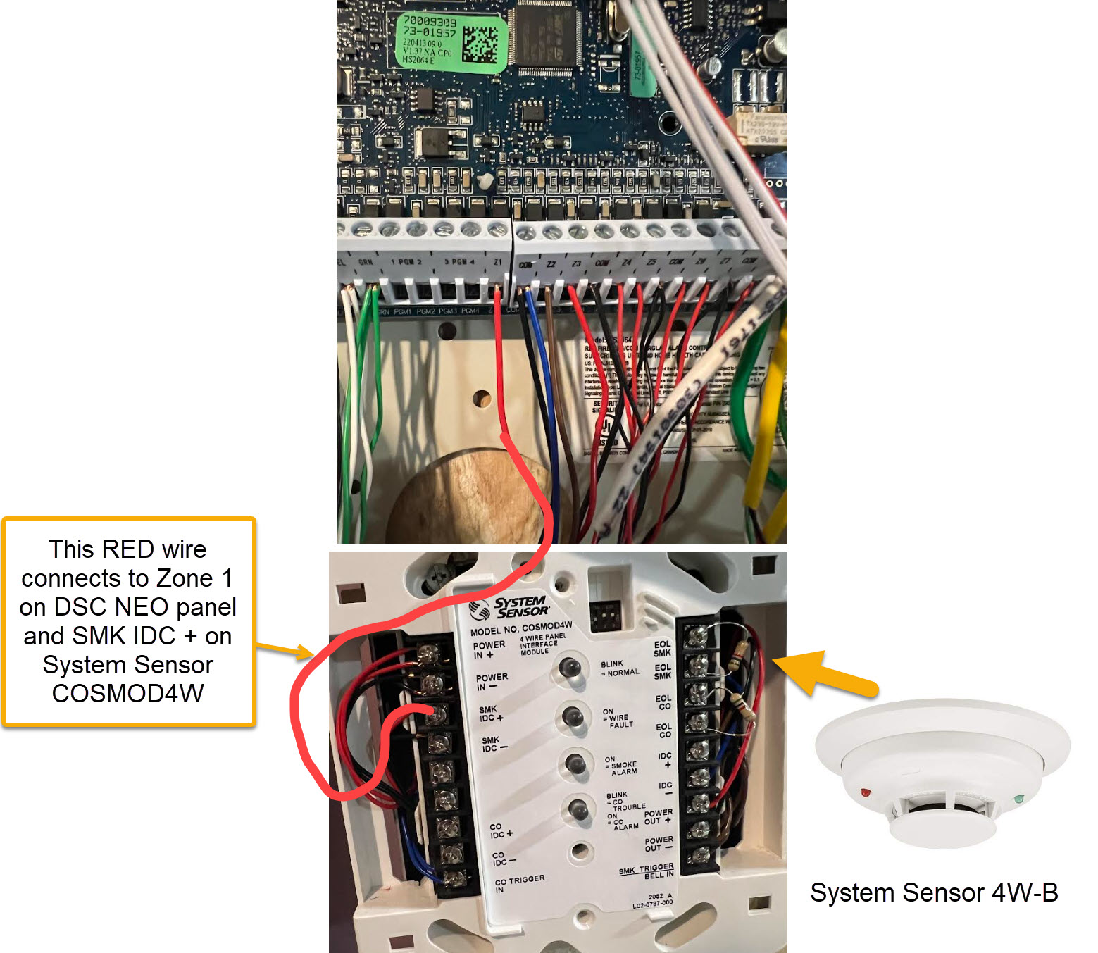

Additionally it looks like these may be wired zones. If so, can you provide a photo of the sensor circuit wiring at the panel and at the sensor?

I will send the connection details/photos later
I do not see any alarm activation at all for that zone on that day. If an alarm occurred locally and sounded on the detector but did not indicate an alarm occurred on the panel, that sounds like the wiring for the detection circuit has a problem.
What model of smoke detector is it? How long did the sensor sounder activate?
I uploaded a diagram of the hardware and connections to zone 1. I have 4-wire smoke alarms (System Sensor 4W-B) wired to a System Sensor COSMOD-4W. This COSMOD-4W is wired into Zone 1 of the DSC Neo Panel.

I have never used the COSMOD4W, but in general if the panel siren was triggered then it got the sensor signal. Was it a normal fire alarm siren or trouble beeps?
