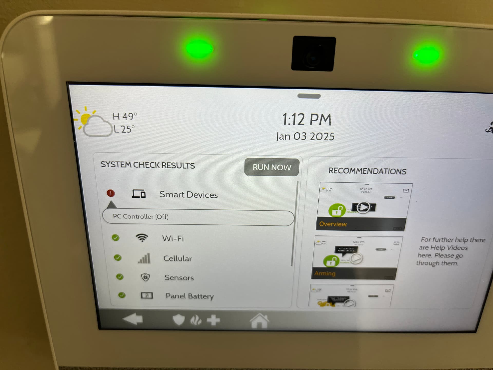

During the New Year Holiday Break, I updated my IQ4 software to the latest, but in doing so have two issues now.
It is highly likely that I messed with some setting that I’m not associating with the problem, hence, I’m asking for advice/help here.
Why in my System Check Results, does it “flag” Smart Devices and indicate PC Controller (Off)?
See image below:
Secondly, why does my IQ Remote (different than the IQ4) not pass the Network Test?
Ah! I think I know what the PC Controller is: I had tried to add a USB Z-wave stick as a secondary z-wave controller this summer but removed it when I read that Qolsys IQ4 panels wouldn’t allow such (at least with the firmware I had at the time). Somehow, the latest firmware must at least recognize that I had tried to do so and is - at least - now “smart enough” to warn me that the Z-Wave stick is no longer present. I’ll need to re-tag that device with a better name so that it is easier to diagnose. Perhaps, I’ll also now see if the latest Qolsys IQ4 firmware allows more than one Z-wave controller.
I’m still a huge fan of the Qolsys IQ4! I just don’t work with it enough to immediately and intuitively know what might go wrong, but can usually figure stuff out given more time. Now - as time permits - to work on the second problem of the WiFi for the remote…
That would be it. I see you have a device labeled that in your list.
Thank you, Jason.
I removed the PC Controller from the Z-Wave devices and connected the IQ-Remote to the IQ4 Panel Access Point and all seems well.
