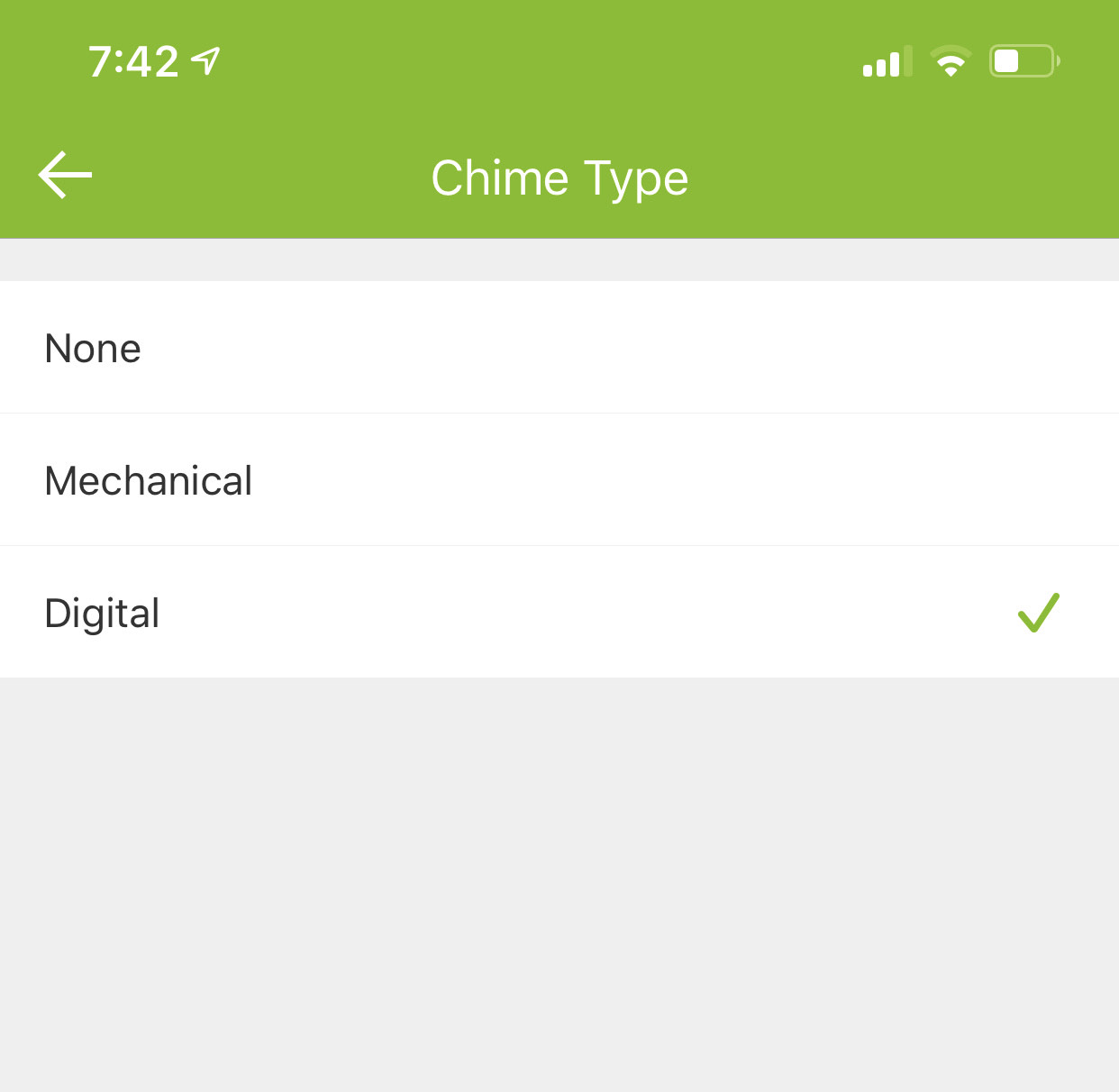

The mechanical chime. Chime in the app works fine, and Skybell makes appropriate noise outside, I also just tested and noticed the indoor chime buzzes loudly between the ding and dong.
I had this exact same problem before. It’s because I had the “digital door chime (mechanical door chime indoors)” on, so I turned it off because I have standard mechanical door bell indoors.
