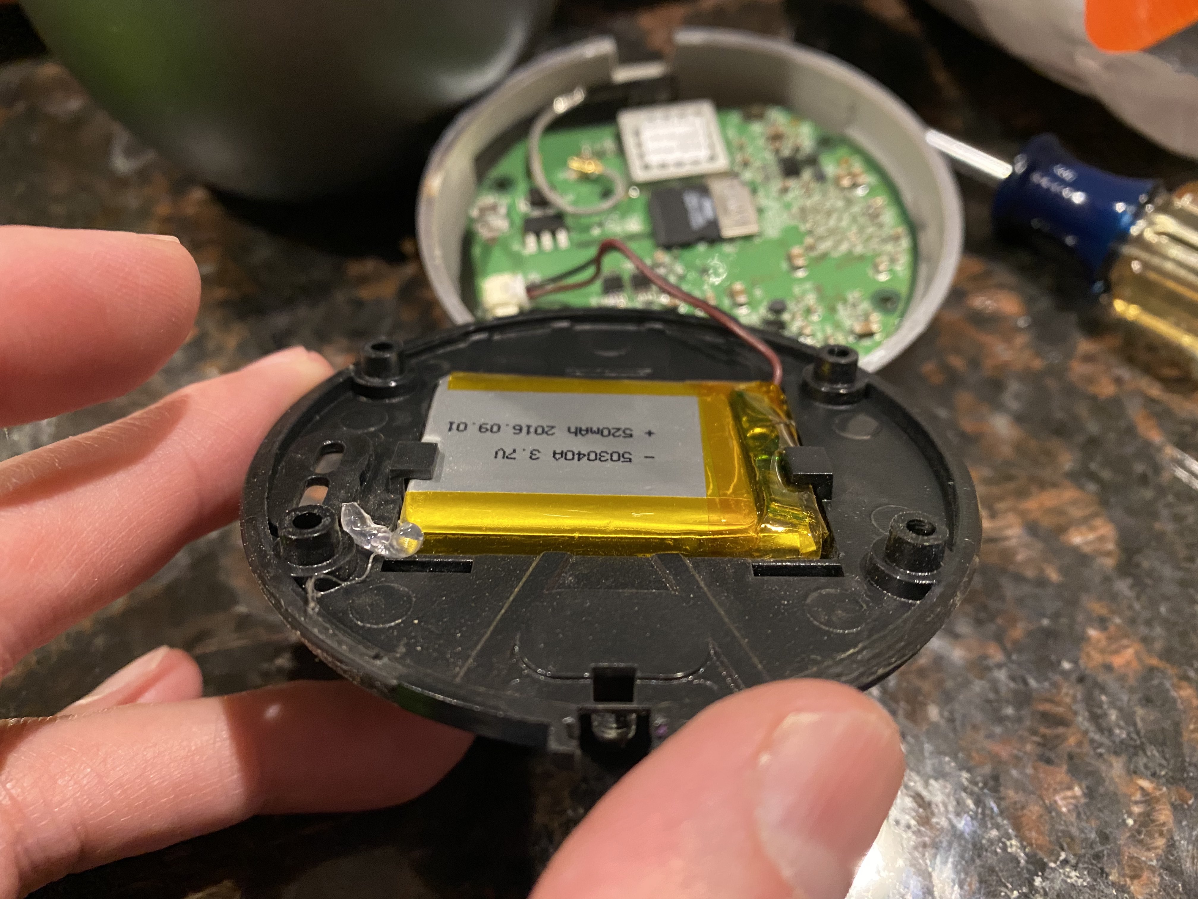

I rebooted the doorbell as instructed and there was no change. I took it off the wall, brought it in and took it apart. The battery looks fine. Nothing else looks damaged, no magic smoke smell etc.

So yeah, that didn’t work either. However, in the course of dicking with this thing, I noticed what looked like a hairline crack in the little plastic dome covering the motion sensor. I picked at it and the whole lens just crumbled so now it’s definitely trash. It doesn’t work now either lol.
