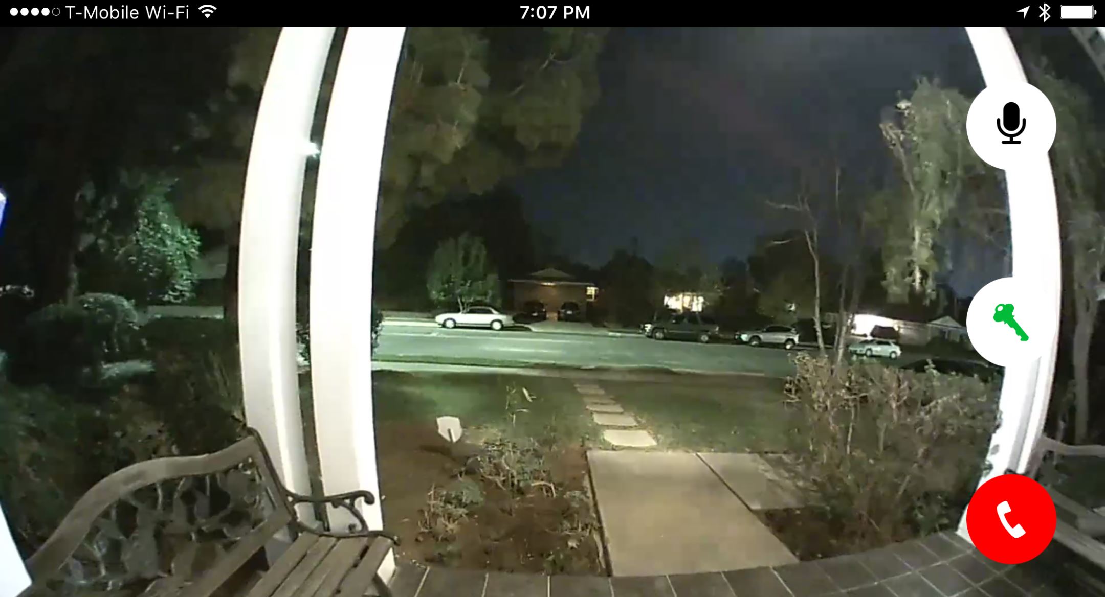

One thing Skybell mentioned is that the environment may be the culprit… I do have two pilars in the front of my house and they were saying this could be causing issues (see screenshot). Do you see this being a potential issue?
What direction does the Skybell face? Given the rather open horizon in that shot I could see sunlight playing a factor with a PIR.
