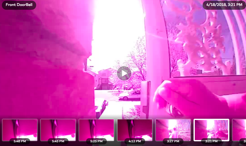

Is my skybell picture suppose to look like this
It has a pink hue as you can see

The image you provided is not typical of the SkyBell HD.
Is the image tinted this way throughout the day, does it look like this in the evening as well?.
It appears that the camera lens is getting the full brightness of the sun. That coupled with the red brick here could possibly be creating this coloring. Are you able to adjust the position (possibly by hand) of the SkyBell and if so is it still producing this tint?

Thanks for the quick reply. I moved my skybell around with same issue. Please see image attached . It is running lates fw 3038
Presumably that is red brick prominent in the camera shot? You’ll want to angle the camera so the brick is out of the left side of the frame. As the original response in this thread indicates, that combined with the direct sunlight is likely the cause.
Angle the cam away from the brick, then power cycle the cam. Any luck?
I moved the cam around with same results … i think i know whats causing it but not sure whats long term fix would be. Basically if i reset doorbell by holding button down for 30-45 sec it works fine for a day. Once it gets dark and IR turns on it stays on forever. This is whats causing Ping hue is infrared lights. is there way to control IR from alarm.com ?
That makes sense, thank you for testing. You can control IR manually on IP cameras through Alarm.com but not doorbell cameras. We are reaching out to Alarm.com to check if there are known fixes for this behavior.
